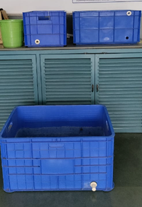

Step 1: Setting Up the Sump and Overhead Tanks
Take 3 crates - two for emulating overhead tanks and one for the sump.
Make two holes (3/4") in the first tank and three holes in the second. Taps, used as water outlets, are fixed onto the holes. *1 TAP OF THE FIRST TANK IS USED FOR LEAKAGE DETECTION*.
Finally place both the tanks on an elevated surface and the sump at the bottom to recreate, on a smaller scale, the water system we see at home.
