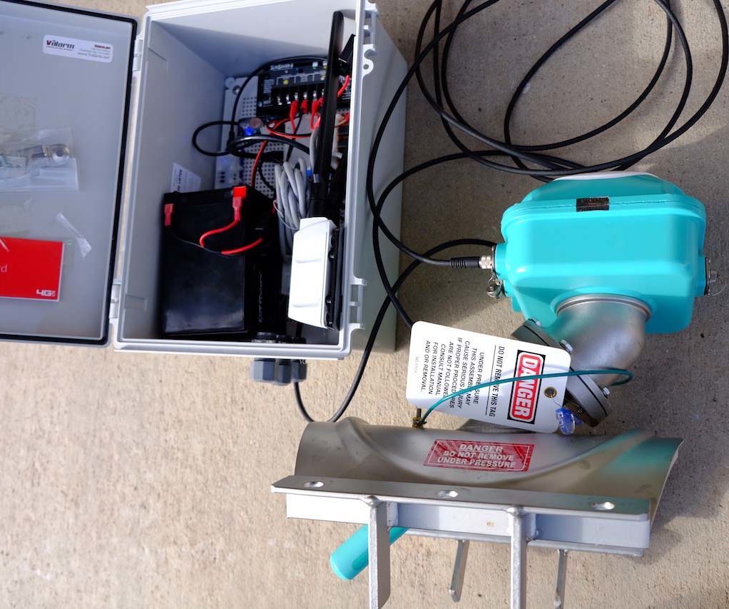

Step 1: Connect Your IoT Sensor Wires and Cables
1st off you'll make sure that you properly connect your IoT water quality sensors. The GF Signet water quality sensors output the international sensor standard 4-20mA signal.
You'll connect your water quality probe sensor to your yellow 4-20mA output box as seen in the photos and sensor documentation. You'll also connect the 4-20mA output connectors to your 4-20mA sensor adapters. In our demo the (1) labeled on the green output block is the positive out and connects to your 23V input channel on your 4-20mA sensor adapters. The connector labeled (3) goes from your GF Signet 4-20mA sensor output box to your 4-20mA sensor adapter signal input / infinity sign you see on the sensor adapter for Channel 1.
You'll need to supply 5V of micro USB power to your sensor adapters. The systems you see in the photos are deployed by county government agencies, water municipalities, and water management resources organizations in the U.S.
These systems connect to standard 110V mains power from a regular ol' wall power plug. The solar charge controller and voltage regulators in the box distribute power as needed to the various components and provide a UPS battery backup system.
The systems in the photos use the Verizon CDMA cell network to upload sensor information to Valarm Tools as often as you need it. You can use WiFi, GSM cell network, ethernet, long-range WiFi antennas, or any other internet connectivity that best fits your scenario.
Similarly with power sources, these systems are totally flexible, so if solar panel power works better than you can harness the power of our sun.
