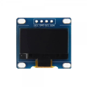

  • 0.96 inch I2C OLED Display

First, I started off with doing some small experiments with the components to see if I could get them to work and how I could get the moisture meter and screen to interact with each other. After doing that, I assembled the components like the image above. I put the screen on a breadboard so that it's easier to attach it to the pot later on, but it can also work without breadboard.

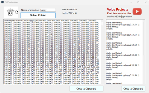

I made 2 short animations in Aseprite for the OLED screen. To make them playable on the screen I followed the tutorial from the channel Volos Projects.

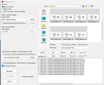

First, I exported my Aseprite animation with the frames as individual .png files. To convert the .png images into bitmap files I used Ifranview. After that, the bitmap files need to be turned into code. To do this, I put the files into the OLEDanimations program like in the tutorial I linked before. Using this code you can put animations on the OLED screen using Arduino IDE.
