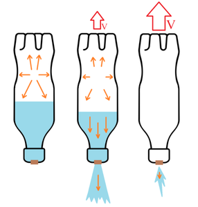

A water rocket is a model rocket that uses water and compressed air inside a pressure chamber (usually a PET bottle) as a thrust motor. The operation of the rocket can be explained by Newton's third law, where the water in the compression chamber is thrown out by the compressed air as it tries to release its pressure releasing the accumulated potential energy, causing a force to be generated in the opposite direction that propels the rocket.

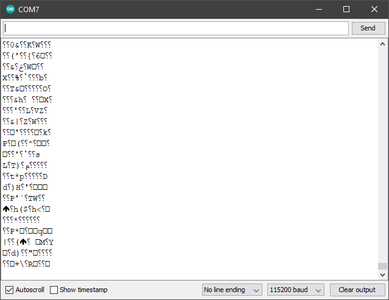

To test if we can receive data, take the cardboard support out of the bottle temporarily so we can turn it on by connecting the power cable to the Power Bank, with the rocket electronics turned on, and the station connected to the computer, open the serial monitor on the arduino IDE at 115200 bauds, if data is being received, you will see random characters appear while the rocket electronics are turned on (as shown in the second image).
If we are not receiving data, check if there are any errors printed on the serial monitor with the station, if not, connect the arduino board on the rocket electronics to the computer and check the serial monitor (at 115200 bauds) to see if there are any errors printed. If there are connection errors with the radio module or the accelerometer, check the connections on the board.
