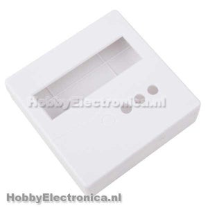

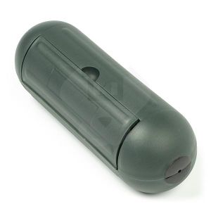

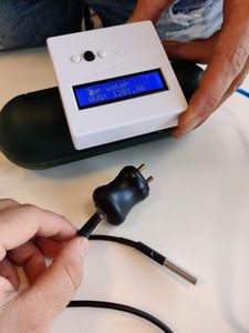

Step 7: Housing and Finishing
Since this sensor will be used in water, it is important to shield all electrical components from the water. For this sensor we built three seperate housings; for the electrodes, for the Arduino and wiring and for the LCD display with the button.
The electrodes were put in a black plastic casing with two holes in the front and one in the back. A hot glue gun was used to make everything waterproof. As said in previous step, it is very important to have the electrodes at a fixed distance from eachother. Make sure they are tighly glued or fixed in place.
The Arduino and wiring were put in a protective box for plugs. This was an exact fit and waterproof at once. You might find something else like this, but for us this was perfect. From one side the power cable could be let in and from the other side the electrodes and thermometer cables could be let out.
The LCD and button were put in a case made for the LCD display we conviently had lying around.
With some hot glue everything was "neatly" put together and made into one sensor.
