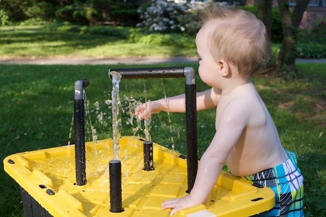

I decided to make a fun water table for my son’s first birthday. He loves water in the sink and the bathtub so instead of getting a boring old tiny pool, I went this route. I wanted fountains and sprayers and a self contained reservoir and pump so it wouldn’t need to be attached to the hose. I got all the goods at a local home-improvement store and got it together in about 2 hours.

Step 9: Make Some Holes for the Water to Come Out
Drill small holes in the plug inserts that point up. Small is key here. If you make the holes too big before you test the water pressure, you could end up with not enough water pressure. You can’t re-drill a smaller hole, only a bigger one. So start small.
Drill some holes along the underside of the horizontal fountain pipes. Take it easy with the size and number of them; you can always add more later.
Step 10: Fill It Up and Test It.
Fill the reservoir with enough water to cover the pump by a couple of inches. You can pour or hose water right onto the lid. Plug the pump in to test the water pressure coming out of the fountains. If it’s too much, unplug the pump and increase the size of a hole or two and test it again. Keep this up until you get the perfect pressure for fun.
