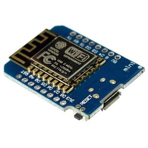

1 x - MCU - Wemos D1 mini (ESP8266) Microcontroller

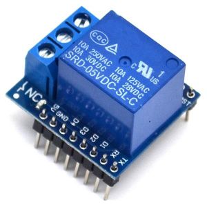

1 x - Relay - Wemos D1 mini relay shield

1. Wemos D1 Mini (ESP8266)
Language:
1. Micropython (version 1.14)

Relay connected to water pump mains supply. Uses the Normally Closed (NC) connection so that if controller power is OFF the power is ON to the pumps. When the Alarm level is triggered the relay is ENABLED which cuts power to the AC sockets and water pumps.

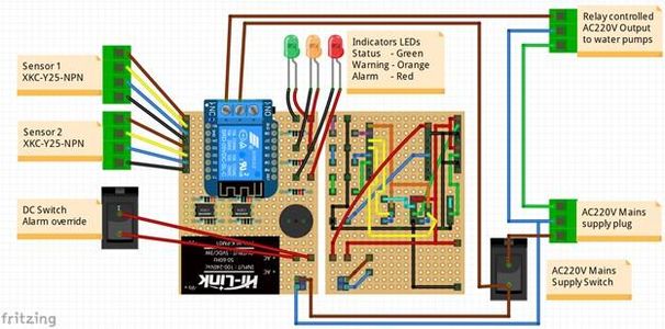

Step 2: Schematic
The critical design elements are:
  1. Be electrically 'safe' as it is AC220V. So use a conventional double wall mounted socket box to house the controller.
  2. Primary control using an ESP8266 MCU
  3. All power derived from AC.
  4. Use the induction sensors to detect water level at 2 pre determined levels. Most of the rest of the circuitry is about linking these sensors to the MCU. The ESP8266 GPIO pins are at +3.3V max. Also the NPN sensor is a SINK so need the optocouplers to invert the signal and voltage level.
Sensors: XKC-Y25-NPN
1. This is a Sinking output sensor. When the internal transistor is Enabled the output lead is connected to Ground.
2. Mode lead determines if Output active is linked to Water detected or no water detected.
Important: For an NPN sensor the Output is ALWAYS a SINK.
3. VCC range +5V - +12V. +5V used here.
4. Wiring: 1-VCC-Brown, 2-Output-Yellow, 3-GND-Blue, 4-Mode-Black
5. Operating Mode: Mode connected to GND.
i) When water detected (Induction positive) then the Output lead is OPEN and the
GPIO sensor Pin is LOW.
ii) No water detected (No induction) then the Output lead is CLOSED to GND and the
GPIO sensor Pin is HIGH.
6. For alternative Mode connect the Mode lead to VCC. This swaps the Output operation.
Induction positive = Output lead CLOSED and connected to GND
No Induction = Output lead OPEN
Note: Not used in this circuit.
Step 3: Circuit Board Design
As you can see I chose a perfboard rather than PCB. Mainly because I am not setup to create a homemade PCB yet. Also this curcuit is relatively simple and even with a perfboard can still fit in the double outlet wall box.
Step 4: Circuit Board Assembled
Top layout looks pretty good.
I'm sure the bottom could be vastly improved but it works well enough.
I know that I did not make use of the top layer for any electrical connections. However, I chose a 2-layer board because it is still very cheap and a lot stronger. No chance of popping pads off the one layer board if you handle it wrong.

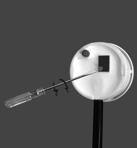

The sensors work by magnetic induction which changes when a more dense medium (i.e. water) is detected.
So the sensors are simply glued to the side of the water tank. No holes needed. I used hot glue.
Testing & Adjustment
My sensors worked without any adjustment. I held them against the tank and moved them above and below the water level and the LED correctly indicated the water level.
However, if the tank material is more dense or if you need it there is an adjustment under the top cover (see photo)

    • The relay will be activated and power turned OFF for the water pumps.
