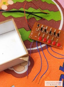

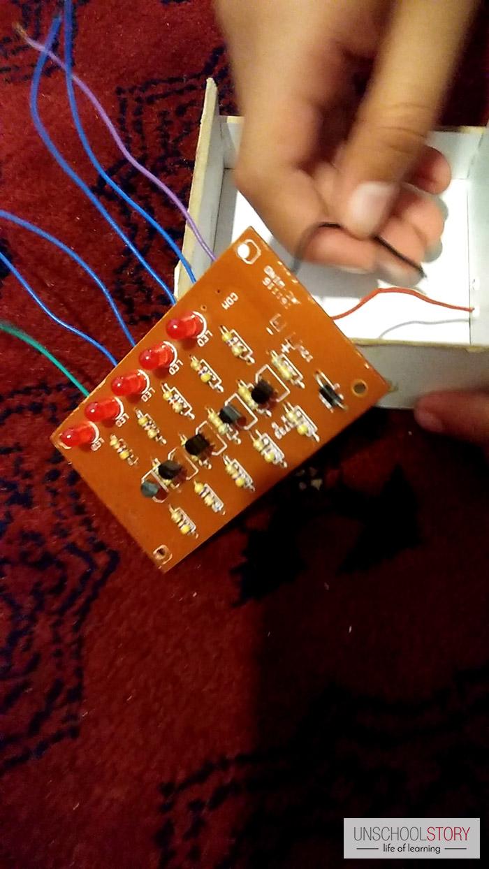

He has a box full of prebuild PCBs in his makerspace, the ones extracted out of various toys and projects. We found a prebuilt board which had functionality to turn on LEDs these would turn on based on the wire connected to complete the electrical path. Before proceeding we did a couple of dry runs simulating the whole thing with a small cup of water.
Step 3: Drilling Holes

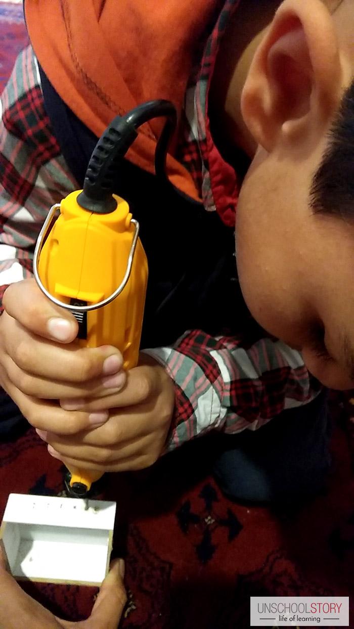

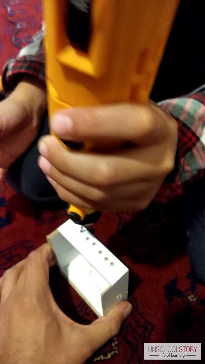

He had a small box luckily it was exactly the size of the PCB (print circuit board). To make it a perfect fit he drilled holes using his new Mini Drill Kit.
All the wires from the PCB were extracted from inside the holes on the boxes.

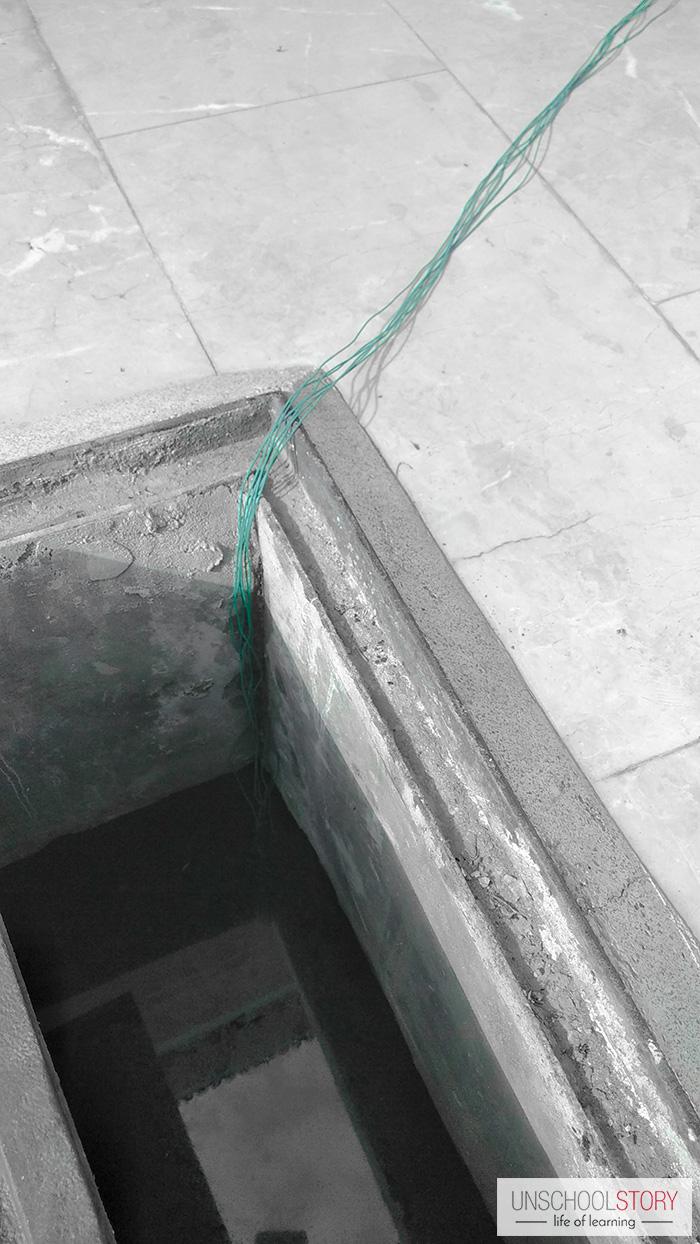

Our underground tank has a depth of about 5 feet. We measured the total distance and had a wire bundle which we cut into 6 shorter wires and each wire less than the other by about 1 foot. Abzy soldered them after which I helped him drop them carefully in the underground water tank.
