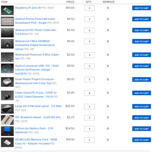

Step 1: Getting Supplies
For this project, you will need the following supplies.
You can view them all on Adafruit here.
  • Raspberry Pi Zero W
  • SD card (8gb or more)
  • Solder-able Breadboard
  • Waterproof Power Connector
  • Waterproof 3-Wire Connector
  • Waterproof 1-Wire DS18B20 Compatible Digital temperature sensor
  • Lipo Battery Changer
  • Lipo Battery
  • Solar Panel
  • Small Waterproof Project Box
  • 2 Cable Glands
  • IDC Breakout Helper - 2×20

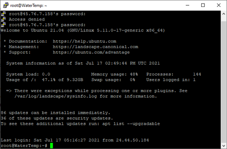

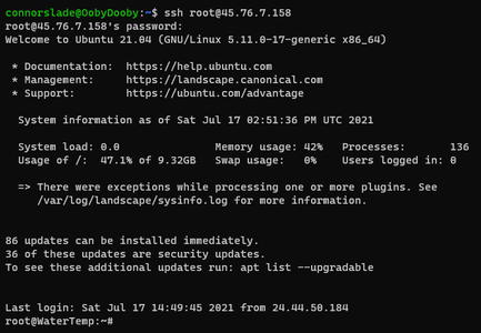

First, you need to ssh into the server. To do this, You can use the ssh command or PuTTY for Windows. If you already know how to do this, then just skip to the next part.
Clicking on the VPS you just created will bring you to a page showing info about the server.
Using the SSH command
Just click the copy button next to the IP address, then open a Terminal Emulator and enter the command ssh root@ where is the server IP. If you are asked "Are you sure you want to continue connecting" say "yes" and press enter. Then go back to Vultr and press the copy button for the root password. Now paste that into the root password and press enter. If it doesn't work, you may need to try pasting by pressing CTRL + SHIFT + V.

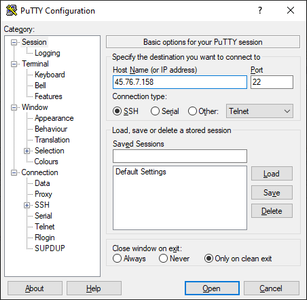

Using PuTTY
Once you have downloaded and installed PuTTY open it. Then go back to the page on Vultr and just click the copy button next to the IP address. Then paste that into the Host Name text input. Click Open, then if there are any popups press Accept. The console window that opens will now ask you what user to log in as. Enter "root" and press enter. Then go back to Vultr and copy the root password. Go back to the Console and right-click on the window to paste the password. You can now press enter.
If you get a welcome message, you have done everything correctly 🙂

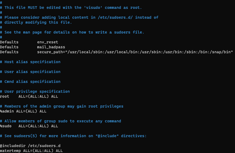

Now we will add our "watertemp" user to the sudoers group. This will allow us to run commands with root privileges later on.
# visudo
Now you will open into the Nano text editor. Use the arrow keys to go to the bottom of the file and add the following line.
watertemp ALL=(ALL:ALL) ALL<br>
Once you have done that, press CTRL + O to save then press enter to confirm. And to Exit press CTRL + X.

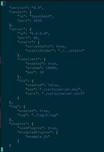

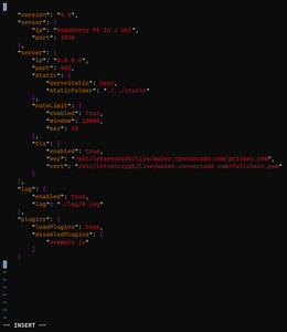

Now open the config file and add the needed values
$ cd ~/WaterTemp/api/config && vim config.json
This should open config.json file in Vim. Press 'i' then navigate with the arrow keys to change the following settings.
  • Change sensor.ip to be the ip of your server. Localhost is good if you are running the web server on the raspberry pi
  • Change server.port to be 80
This is all that is needed to be changed for now. Press escape then type ':wq' and press enter.
Change the TLS section to be the following, where is replaced with the domain you are using for this server. For example, with water.connorcode.com my key file would be '/etc/letsencrypt/live/water.connorcode.com/privkey.pem'
"tls": {
    "enabled": true,
    "key": "/etc/letsencrypt/live/<YOUR DOMAIN>/privkey.pem",
    "cert": "/etc/letsencrypt/live/<YOUR DOMAIN>/fullchain.pem"
Now that you are in your Config file, edit the server.port to be 443. This is the HTTPS default port. Now save and exit with Escape then type ':wq' and press enter. Just rerun your server and check that HTTPS is working.

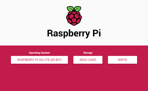

Download the Raspberry Pi Imager here. Using this, Install Raspberry Pi Os Lite on your SD Card. Now remount the card. On the boot partition, make a new file named wpa_supplicant.conf and put the following text in it.

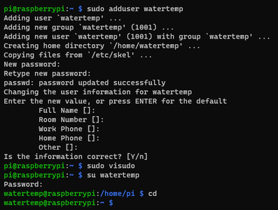

Now we will be setting up the software on the Raspberry Pi. Like before, we will be creating a new user account and adding it to the sudoers group, like in step 4. Keep in mind, the default password for the pi user is 'raspberry'. When running visudo add the line 'watertemp ALL=(ALL:ALL) ALL'.
$ sudo adduser watertemp
$ sudo visudo
$ su watertemp
$ cd ~

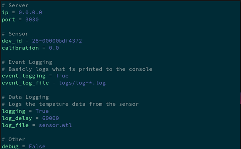

Ssh to your Pi again and use this command to open the config file
$ vim ~/WaterTemp/sensor_Interface/config.ini
Here you will need to change some settings.
  • Change ip to be '0.0.0.0'
  • Change port to be the port you chose (or 3030)
  • Change log_delay to be the time between collecting data points in ms
