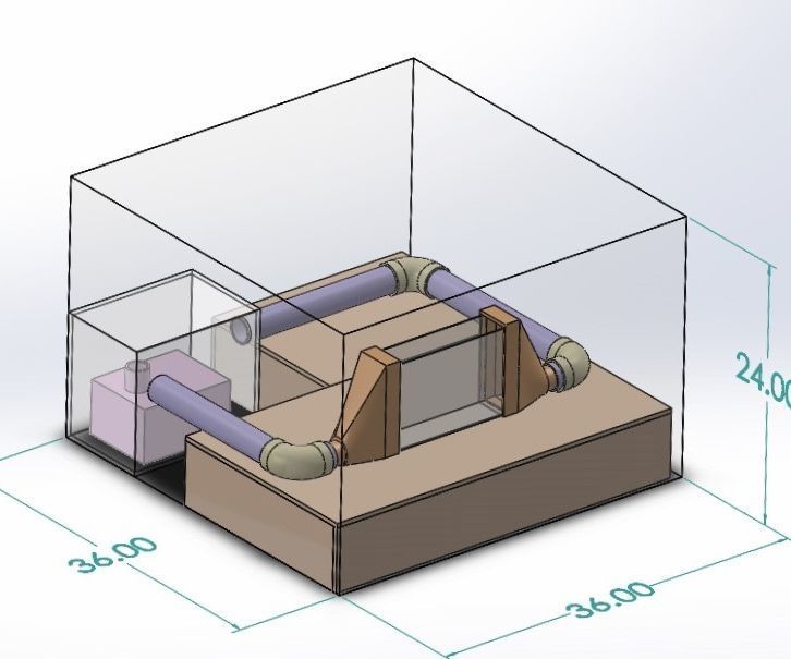

Step 1: Fill Reservoir With Water
- Remove reservoir top.
- Fill with water, ensuring that water height stays within markings (4-6 inches).
- Seal reservoir.
Step 2: Place Geometric Insert in Test Section
- Snap desired geometric fitting into female fasteners inside test section.
Step 3: Turn on Pump
- Ensure top of pump is not fully submerged before operation.
- Plug pump into wall outlet.
Step 4: Control Water Velocity
- Slowly rotate knob on the control variable switch counterclockwise until pump reaches its maximum output.
- Slowly rotate knob in the opposite direction (clockwise) to reach the desired speed.
Step 5: Observe Flow in Test Section
The water tunnel is now running; enjoy study and analysis of varied flow types. Try using different geometric inserts and flow rates to experiment with various models of flow!
