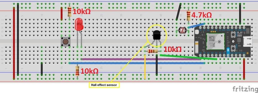

The first thing to start with, is working on the electronics. Before putting it all together, make sure to solder some extra wires to the Hall effect sensor and the LDR, before plugging it all onto the breadboard.
When connecting the Hall effect sensor, the flat side (with the text on it) is considered the front of the sensor. So make sure to get the orientation right, just like in the scheme.

The code that can be used for the sensor can be found in the .txt attachment. It continuously measures the light intensity on the LDR. When the light intensity hits a certain threshold, the LED on the breadboard will light up. The acquired data will be printed to both the particle console and a terminal.
Upon hitting the reset button, the light intensity at that point will also be published, allowing for light intensity measurements without having to use the mirror-lift.
The hall sensor will measure how often the magnets will pass by, and will multiply it accordingly to convert it to the proper length. It isn't super accurate however, since it will only measure every half cycle.
