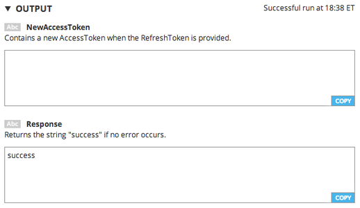

Once you've filled out all of the Input fields on the Temboo AppendRow Choreo page, test the Choreo from your browser by clicking Run at the bottom of the window. Now, if you check the spreadsheet you created to store the data, you should see that the first row beneath the column header has been filled in with the character that you provided in the RowData Input field. Back on the AppendRow Choreo page, you should also see that a box entitled Response and containing the string “success” has appeared under Output—it probably will not surprise you to learn that this indicates that your Choreo has executed successfully.
If your test run fails, an error message will appear explaining why. One common error occurs when Google’s security checks flag the API call that you are making as an unauthorized attempt to access your account. If you see this error, you should turn on 2-step verification on your Google account and create an application-specific password for Temboo. Use this password in the Password Input field, and you will be able to access Google’s APIs using Temboo.
