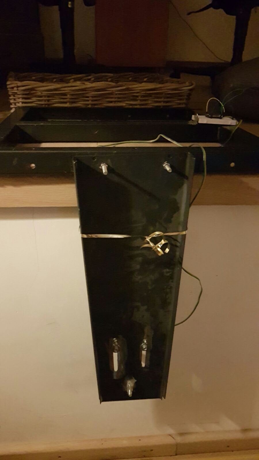

The frame is made out of two pieces from an old desk. For a clear view of the layout, we've made a 3D model that you can look at to get a basic view of the sensor. In this model the blue part is what we call the frame. The top part of the frame is to support the construction so you can suspend it anywhere you want. Bolted to the top part is the downward facing part. This is what provides the height so you can get the sensor into the water without getting the equipment wet. The height of this part is dependent on how deep your water level is relative to where you can suspend the frame. For easy adjustments we made two slits into the steel plate. In this way we can easily raise and lower the sensor. If the slits do not provide enough adjustment you can also drill new holes from where you can bolt the plate to the top part.
