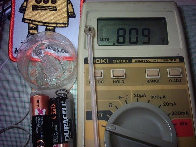

Seal a Microchip TC1047AVNBTR temperature sensor into a plastic tube to make it impervious to water and most other liquids. This is intended for use at low temperatures. The photo shows the completed probe, powered by three AA cells, measuring the ambient temperature as 30.9 degrees celsius.

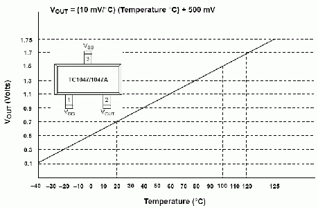

The figure, copied from the data sheet, gives the salient characteristics of the TC1047 temperature sensor manufactured by Microchip. The supply to the sensor can range from 2.7 to 5.5 volts and it converts the temperature to a proportional voltage with a fixed offset of 500 millivolts.
Thus this sensor is ideal for measurement where the result is to be interpreted by a human. A multimeter in it volts range will show the temperature with an offset of fifty. Zero degrees Celsius will result in 500 mV. 100 degrees Celsius will result in 1.5 volts.

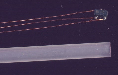

Step 3: Solder Wires
I used thin enamelled copper wires to solder to the three leads of the sensor. Although they look like copper, those three wires have a thin coating of enamel which prevents short circuits when they touch each other.
The writing tip was removed from the refill and the tube washed out with some solvent.

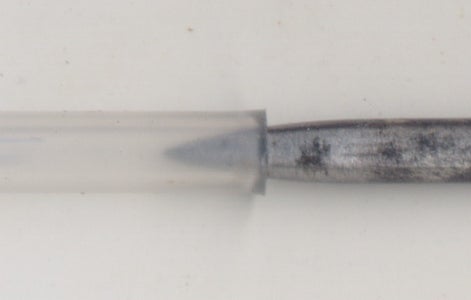

Step 4: Enlarge the End of the Tube
Although the SOT23 package of the sensor is one of the smallest, the tube was too small to house it. So its end was made a little larger by forcing an awl into it. You might try a nail, too.
Step 5: Warning!
I found that heating the awl made this part of the job easier. The business end of the awl was made hot by holding it in the flame of a cigarette lighter and then it was pushed into the tube, enlarging it in the process.

Paper clips bent into a "V" make great plugs to go into the sockets of a multimeter. Three AA cells in a four cell holder were used to power this sensor.

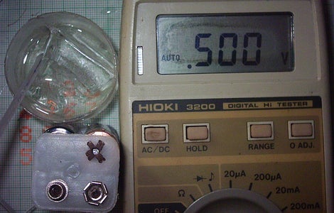

Step 9: Calibration
There is nothing to calibrate, as microchip have already done that at the factory.
Immersing the sensor in a mixture of crushed ice and water gives an output of 500 millivolts, thus proving that my meter is accurate. Actually, the reading fluctuates a bit, this exact zero reading needs a bit of work with crushing ice and stirring it up to get to.
For occasional use, this sort of jury-rigged arrangement can be made to work. For a more professional instrument, an auxiliary circuit to subtract the .5 Volt offset could be incorporated, thus enabling the meter to show the temperature in degrees Celsius directly.
