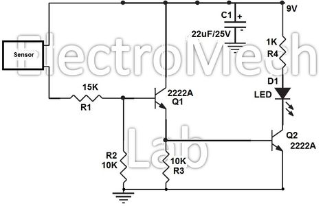

Water Sensor Circuit: This circuit can be used to detect water level and same circuit can be used as rain sensing circuit the only need to be replaces is the sensor.

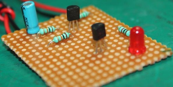

Step 2: Go Through the Following Steps
1- Mount all the components on the PCB according to the circuit diagram.
2- Connect the battery with correct polarity.
3- Connect the sensor wire together to test initially.
4- Put the sensor wire into the water, LED should glow.
