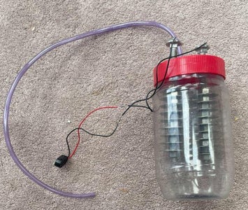

  7. The second image is my setup, with the tube sticking out of the red lid, please note, I did not use a switch as I can just pop the battery in and out when needed. You can see the two screws on the right with the washers and nuts.

Press the switch once the battery is in the holder, and you should see bubbles rising from the steel washers inside the Jiff jar. If you decided to pour a little drain cleaner in the water, you should see a higher rate of bubbles, which means water is being separated into hydrogen and oxygen gas. You did it!
