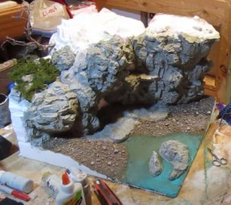

Step 4: Painting and Applying Dirt
I usually like to add the resin before applying all the turf and foliage so that as the resin is drying no flakes of grass can get caught in it. But before the resin can be poured, certain areas should be covered with terrain so that the water can't trap any area that is unpainted, locking it away forever. So before I did anything else, I created the rocky beach below, painted the area where the resin will be poured, and painted some of the rocks as well.
Before pouring resin it is best to make sure the base color of the place you want to paint is not pure white. It should either be the same color as the water to blend in completely, or the color of dirt or sand to look like the bottom of the water. For this project I wanted the water to seem really deep so I painted it the same color as the water. For the area where the resin will be poured, I used two or three different shades of blue and mixed them together to imply shading; the shallower areas are in brighter blue and the deeper areas are in dark blue.
The shore area I wanted to seem like it was made of a bunch of small to medium sized rocks and pebbles. For this I found a patch of dry dirt near my home with a lot of differently-sized granules and almost-microscopic rocks. First you need to p;aint the area you want to apply the rocks brown; you don't need to do this if you want to paint the rocks after gluing them down as I will be doing, but it is just about necesary if you aren't going to be painting them later. This way the foam and plaster does not show udnerneath after the rocks have been glued down; and believe me, even if the entire surface is covered with rocks, you will be able to see a lot of the white plaster showing through if you do not paint it beforehand. After painting it, spread elmer's glue or whatever similar glue, usually called PVA glue, over the area you want to have dirt on it, and then sprinkle the rocks over it; then after it dries, blow, brush or shake off the excess into the trash or back into the bag for later. To make sure it has been adhered perfectly, use the same white glue and dilute it with water, then soak the whole area in the solution using a pipette, spray bottle, or whatever (make sure to dab away the excess glue with a rag or paper towel.) Then paint the rocks. I used a watered-down acrylic brown color, and drybrushed with a little antique white.
To paint the rocks, I used a medium grey acrylic paint, watered down just the tiniest bit so it could flow better; I then did a drybrush of antique white, and finally I covered it in very, very watered-down olive green paint. The result is a surprisingly realistic grayish-almost-green color.

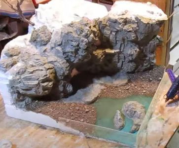

Step 5: Damming / Resin Pouring
We are almost ready to pour the resin, but in order to do so it must be dammed very tightly, or else the resin will spill everywhere. For this I used a sheet of plexiglass cut very accurately on a tablesaw, but using a conventional saw will work fine. Really, lots of materials can be used to create a dam, such as popsicle sticks or even just tape, but for this project I wanted to make sure the dam was strong because of how deep the lagoon is and how much resin will be poured. I applied the plexiglass to the sides of the lagoon using hot glue and to make sure that there were absolutely no cracks, I took clear tape and taped all the sides firmly together so there was nowhere the resin could leak out of.
Then I poured the resin. There are a lot of tutorials for resin pouring and this time there was not very much different; so I will only say to look at those tutorials if you want. Resin-pouring is its own entire tutorial. But for here I will say that I used acrylic paint to dye the resin. The resin I used was Alumilite clear cast resin, and the package says to not use acrylic paint to dye it, and it is true that if you are trying to tint the resin a solid color using acrylic paint, the color will be inhibited (so that the surface is still slightly tacky or that the resin flexible), but that is only if you are using a whole lot of acrylic paint. For this purpose we obviously want the water to only be a little opaque, in fact the more you can see through it the more convincing it will be, so the amount of acrylic paint used here will not inhibit the cure enough to make any difference. Now during this project I made the extremely unfortunate mistake of using a little too much acrylic paint in the resin, so the water is way too opaque; but even at this level of opacity, the resin cured without any tackiness, so it just goes to show how much acrylic paint you can use to dye this particular resin.
