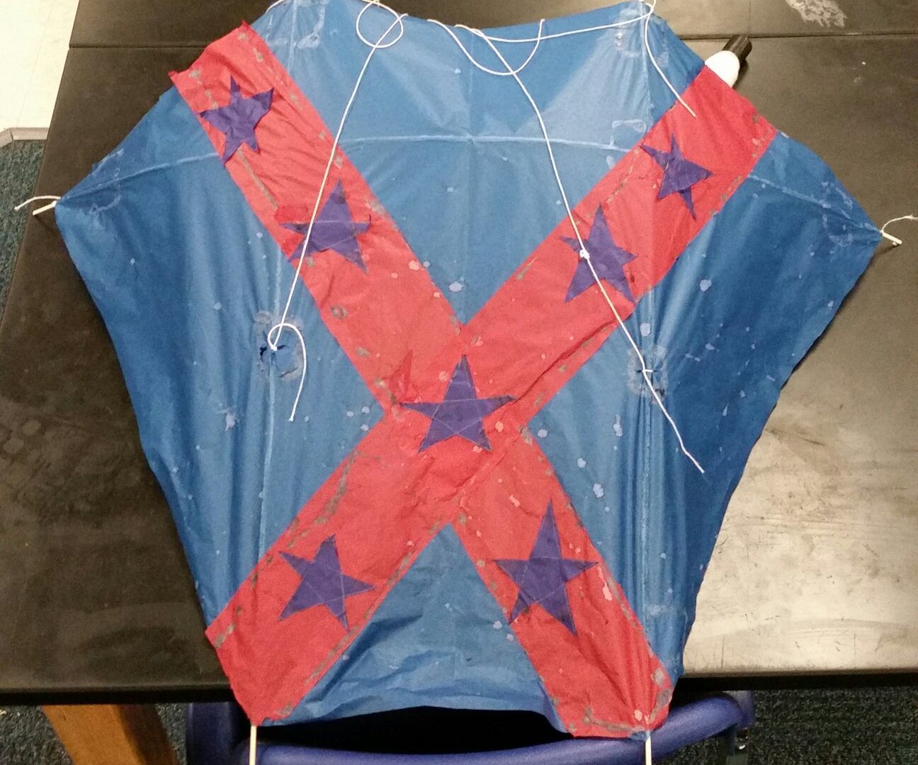

Step 5: Decorate the Seeds
Make the seeds of the watermelon by cutting some black tissue paper in small patches for the seeds. next you place glue over the green rectangle then you put it on the red.
Step 6: Flex the Kite
Add a dihedral flex by tying a piece of string tightly around one side to the other side to make it bend.
