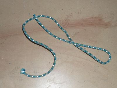

2: Short length of braided cord of some type. (something with a tight weave that is fairly smooth)

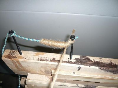

--- Start by tying the twine and the cord together in a square not.
--- Next, secure the cord to something stable. I used a 5" decking screw in a sawhorse.
--- Use a second screw to create a loop point just before the square knot you just tied.
--- Cut the twine to length. Again, i used about 10ft for this demo, but you can use what you like depending on how large of a bundle you want.
--- Now that you have the setup done, make the first wrap as shown in the picture.

--- Continue to wrap the twine around the cord until you have about a 2" bundle started. Be careful not to wrap this too tight, you only need enough tension to keep the wraps close together.
--- Once you have about 2" wrapped, start overlapping the wraps in the opposite direction. Once you reach the loop point screw, change direction again. Wrap back and forth until you have taken up all of the twine you cut.
