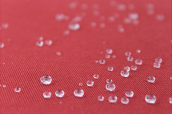

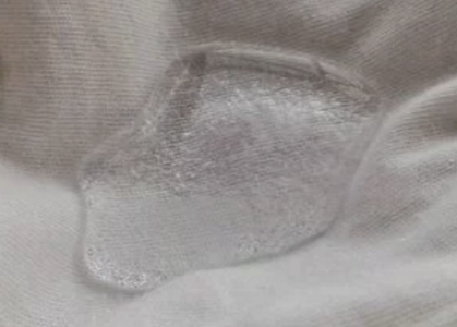

Superhydrophobic Coating: It makes the angle of the surface greater than 150 Degree, thus making all liquids roll off the surface of Fabric! This Phenomenon is similar to the one seen in Lotus Leafs!

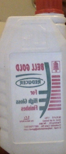

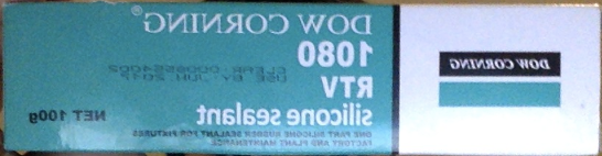

1. Clear RTV Silicone Sealant (Room Temperature Vulcanization Silicone Sealant) [I used Dow Corning 1080 RTV Clear Sealant]
2. NC (NitroCellulose) Thinner
These will be easily available in any Paint & Hardware Shop! And would cost less than 5-6$ and work for many pieces of fabric!

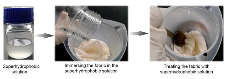

Step 4: Steps:
For Small Clothes:
1. Put about 50 ml of paint thinner in the bottle
2. Squeeze out about 5 grams of RTV silicone sealant in the bottle containing thinner
3. Close the cap and shake the bottle to mix.Shake until there is no leftover RTV silicone on the bottom.
4. Your solution i ready, now pour the solution in to the container and immerse the fabric.
5. Leave it for five minutes
6. Take out the fabric & keep it under sunlight until completely dry
