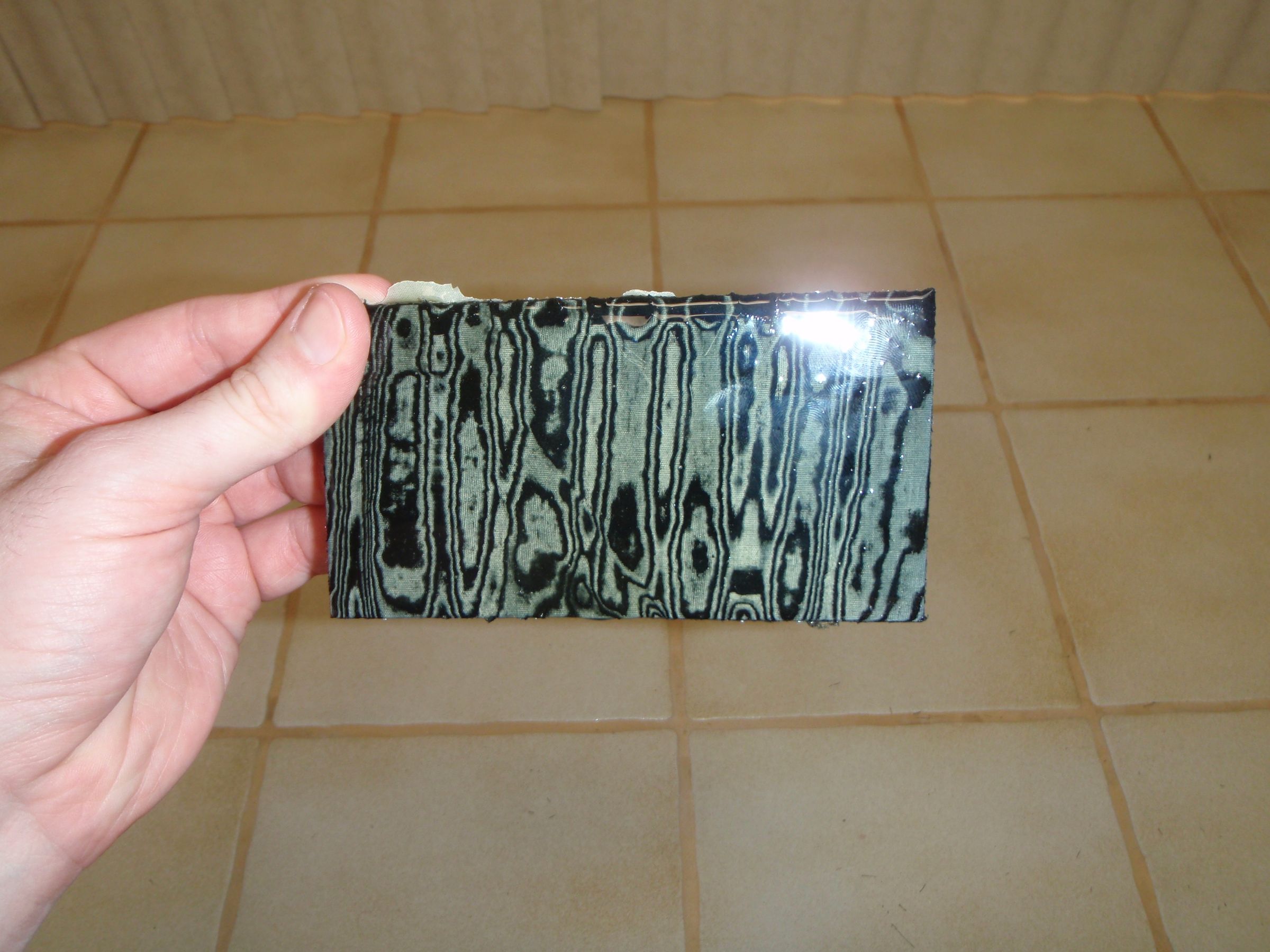

- Waterslide labels are easily repositioned while wet. With "peel and stick" labels, you usually only get one chance to position the label perfectly. If you mess up, peeling up the label will often damage the target surface, or "crease", "kink" or otherwise damage the label. As long as you are gentle, and as long as the target surface and waterslide label remain wet, the label can be slid into perfect position.
- The extreme thinness of waterslide labels makes their edges all but disappear on the target surface. This makes the artwork look more like it was painted on and less like a label. If you paint over the image with transparent colors (aka "candy" colors) you can achieve amazing depth effects and cause the label edges to disappear completely. Airbrush artists love waterslide labels for this very reason.
- By coating the finished item with a clear coat (gloss, satin, or matte, your choice) the label and the target surface take on the same degree of "shine", further concealing the label. Peel and stick labels will often "shine" relative to the target surface, making them stick out like a sore thumb.
- The thinness of waterslide labels makes them conform better to curves than "peel and stick" labels. I will demonstrate this on some nice curvy, fragile eggs.
Although this Instructable focuses on eggs (it's my entry into the Egg-bot challenge), it's a great technique for automobile modders, computer case modders, steampunkers, haunted house makers,model makers, and instrument panel makers because of the slick "custom painted" results you can get with very little practice.
