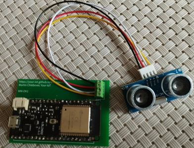

Watmonitor is a lightweight web dashboard originally designed to visualize water levels using graphs and real-time outputs. Over time, it turned out to be just as useful for monitoring any liquid, or bulk material levels. This opened up applications across many industries — from agriculture (grain) to energy (coal, pellets, biomass) and even manufacturing (granulates). Standardly Watmonitor works as a central interface that communicates using API with sensor node (DIY hardware / industrial hardware), that is performing measurements.

  3. Sensor node (DIY Arduino / ESP32 or industrial)
To be able to run Watmonitor on your side, you will need to have Webserver. You can host it locally on your computer, or Rpi board. There is also possible to host it via webhosting. Watmonitor is compatible with PHP at least 7.0 up to the latest version of PHP 8.4 (valid in end of September 2025). I had good experience with Apache (HTTD), but also NGINX.
As database you can use MySQL or MariaDB database, both are SQL database type. Standardly database is administrated using Adminer or phpMyAdmin tool.

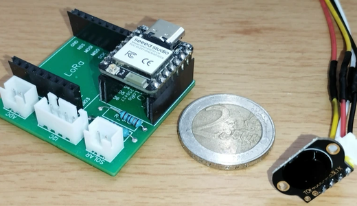

Watmonitor comes with wide database of source codes for ESP32, ESP8266 or Arduino including WiFi, Ethernet, PHY Ethernet or also LoRa, LoRaWAN, NB-IoT connectivity. There are multiple examples for ultrasonic distance sensors (HC-SR04, JSN-SR04T...), or also for ToF laser sensors (VL53L1XC - TOF400, VL53L0X - TOF200C). There are standard implementations and then more advanced with ULP or OTA modes present.
For ESP32, there are implementations for ESP-IDF 5.X framework with FreeRTOS operating system and inter-task communication aswell. These source codes are available for fast development and prototyping compatible with Watmonitor interface. Also you can build your own sensor node based on industrial hardware STM32 with Murata / Inventek WiFi modules, also it is possible to integrate 3rd party industrial hardware to Watmonitor, if it supports HTTP(S) POST request. As web interface is universal, you can use any sensor technology you like.

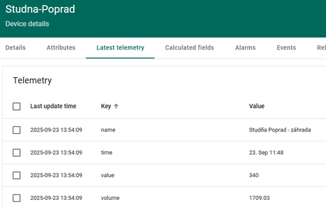

Watmonitor can be integrated into ThingsBoard IoT platform. It is not a trivial job, as ThingsBoard is using Push model. That means, the platform can't get data directly from a source, but a source need to send data to the platform using via REST API (HTTP) or MQTT.

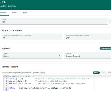

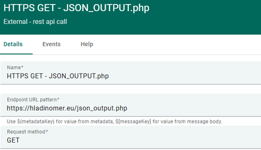

Due of that, it is possible to do a separate CURL request from Watmonitor that will send data to the ThingsBoard, but alternatively we can use its functionalities. It is possible to create custom widget, if we are interested for the latest data only. But in case we are looking for time-series data, it is good to use Rule Chain (works similar to Node-RED). It is able to create HTTP GET request each XY seconds, minutes based on generator node, which is creating a "tick" and that can run the whole flow.
Alternatively we can use also Node-RED that is able to push data into ThingsBoard via HTTP request, or using MQTT to its broker on 1883 or secured 8883 port. In that case and also in case of Rule Chain, values and variables are stored in telemetry of pre-created device. ThingsBoard allows you to do postprocessing with the variable within dashboard. Meaning, you can calculate actual water percentage present within a known waterwell depth, etc, even you have only value in cm of the current reading. Rule Chain within ThingsBoard allows you to do automation too, anything is possible to do, directly or via 3rd party webhook.

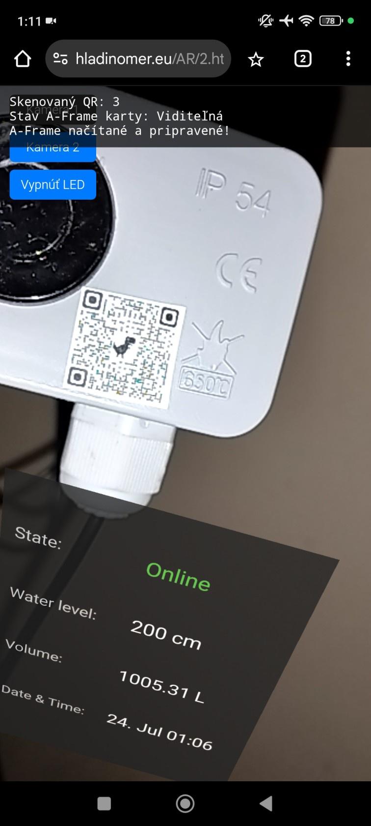

Step 4: QR Scanner
HTML5 based webapp which is using Instascan tool for scanning nearby QR codes using phone's camera. Once the correct QR code is present, it will trigger HTML5 table that is printed on the screen with the latest data. It is connecting to the API1 endpoint, where it gets the latest data.
Great for big installations with many sensor nodes. By scanning QR code you will also get web interface's name of Watmonitor, which can be also used for sensor node name. The webapp is using WebRTC API for controlling flashlight of the phone, which is helpful for waterwells, tanks where is dark and QR code needs to be readable.

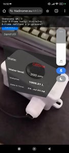

Step 5: AR Dashboard
Orbital visualisation of AR within webapp. It is based on A-frame JS framework. It is using the same principle as QR scanner, the goal is to scan the exact QR code to trigger AR scene. Once AR scene trigerred, you will see dashboard present on your screen within real world that is visible via camera of your phone. As its orbital visualisation, you are able to move object with your finger around your axis. It can be extended for WebXR, which allows you to create an object within scene and it will be present on the original location only. That requires also more phone's functionalities, as it needs to measure nearby space, room.
