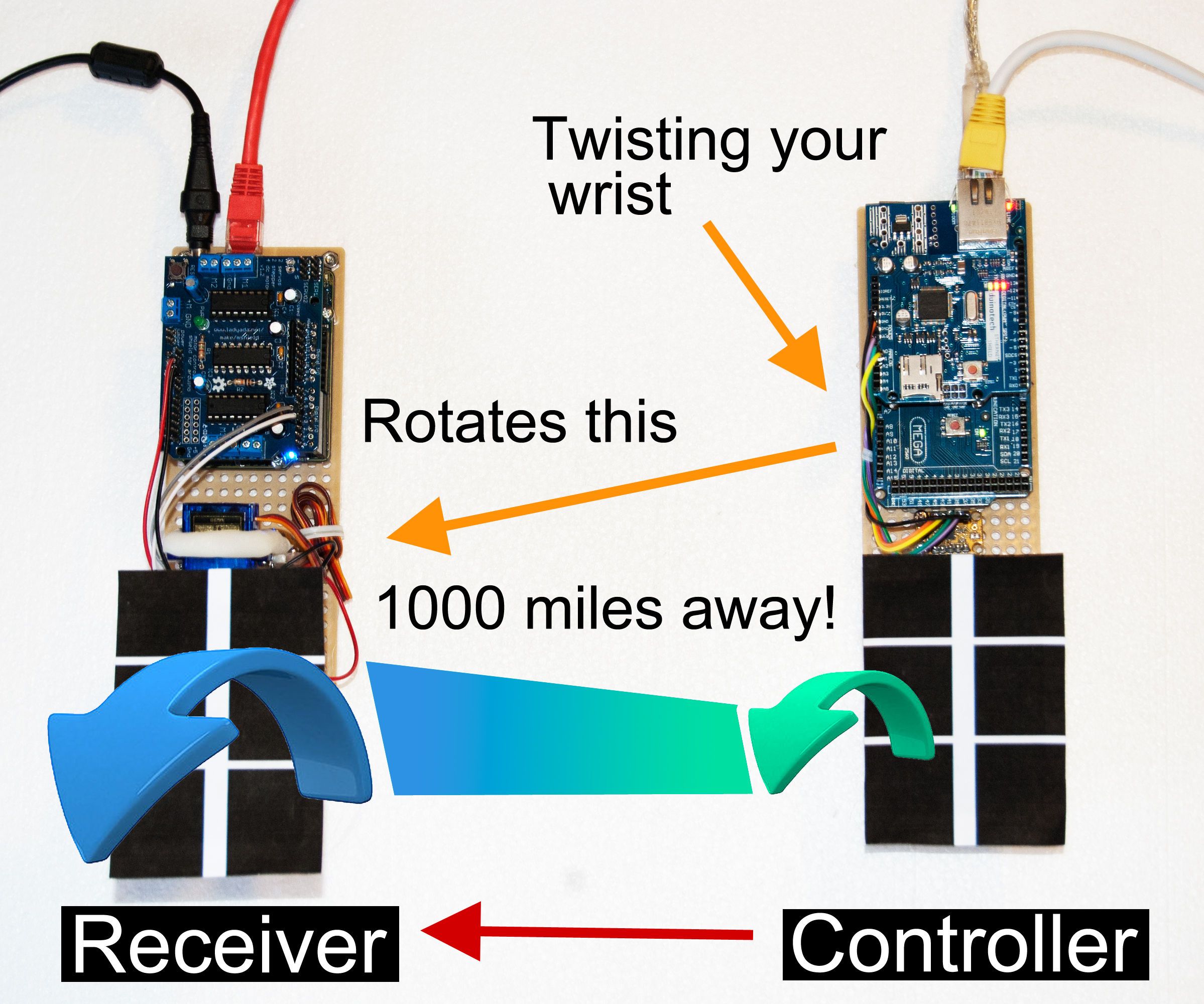

Introduction: Watson IOT and Node-RED Controlled Robotics
The following Instructable is an IOT motor device that is controlled by an accelerometer based Controller through the Watson IOT platform.
Angling the controller adjusts the IOT motor device to match the pitch and angle of the controller. Being IOT based means the controller can move multiple IOT devices across the entire planet with a simple flick of the wrist.
Whilst this Instructable includes the basic detail regarding both the motor device (receiver) and controller, the focus of this step through will be on connecting to the Watson IOT platform and Node-RED.
I have created another instructable which focuses on the hardware (i.e accelerometers, servos, arduinos) and it can be viewed here.

Step 1: Component and Application Overview
The above diagram gives an overview of how the system hangs together in its entirety and the following is a breakdown of each item.
The Controller
The controller is a simple device that sends the X,Y, and Z axis data from an accelerometer to Watson IOT platform using the MQTT protocol.
Components Include:
- Arduino Mega 2560
- Ethernet Shield
- Acceleromete
MQTT
This is the protocol used to communicate directly with the Watson IOT platform. It is a lightweight protocol perfect for fast data transfers on IOT devices.
Devices Publish “Events” (like the axis data this project sends) and Subscribe to “Commands” from applications.
- Note: Devices can not subscribe or publish directly to other devices unless they are registered as a gateway device. An Application is needed in between two devices.
This “Publish / Subscribe” methodology removes the one to one relationship between devices and creates the ability to scale fast.

The Receiver (IOT motor device)
This purely a Ethernet based Arduino (Freetronics EtherTen) that receives the data passed from the Node-RED application and sets the X and Y Servo’s to the desired position.
Components Include:
- Freetronics EtherTen Arduino
- AdaFruit Motor Shield
- 2 x Servo motors
