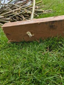

Step 2: Drill and Varnish 2x4s
We used the electric drill to make 4 holes right through each 2x4 (approximately 10 inches apart) they were varnished using spray.

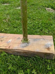

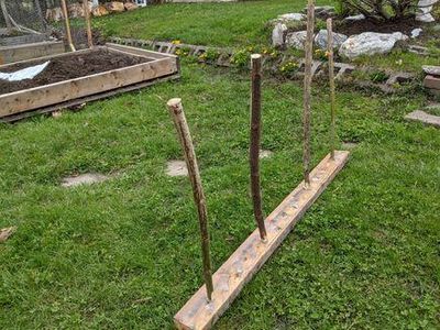

Step 3: Sharpen and Insert Stakes in 2x4s
(the next day after the varnish dried)

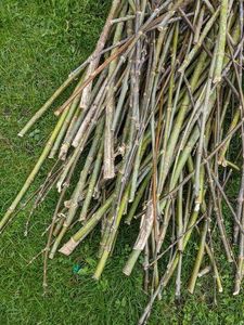

A machete was used to sharpen 24 recycled strong sticks and hammered them securely into the 2x4 holes.

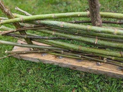

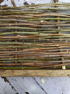

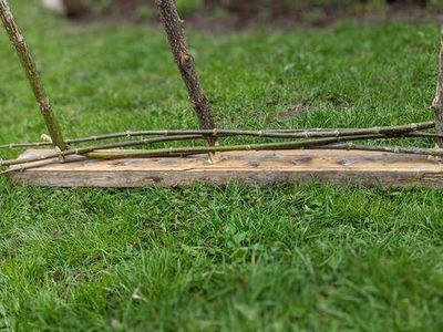

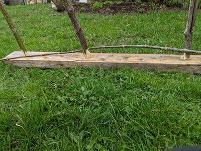

Step 4: ​Weaving the Branches Between Stakes
We weaved and compacted the fresh branches along the vertical sticks in each 2x4. We made sure to alternate the branches to ensure that in one row the branch started in front and for the subsequent row, the branch started in the back. This was repeated until a 3 foot stack was achieved. Smaller branches were weaved through any big spaces that emerged. We stopped at when we reached 3 feet. The weaving part took about 30 mins to construct a 4 by 3 foot wattle.
