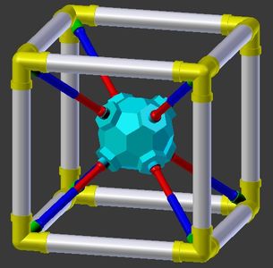

For this prototype I used tubes of PVC :
  • 2 of 2’’
  • 2 of 5/8’’
  • 2 of 3 /4’’
  • 8 simple 90° elbow joints of 2''
  • 8 simple T joints of 2''
  • 8 plastic caster wheels
  • Copper wire
  • Neodymium magnets (Any magnet will work but it won’t generate as much)
Step 3: Cuts
This project aims to show the basics of wave power conversion si it won't generate that much current/voltage
For a first try the measures are this:
1) Cut the 2” tube into 7.4” segments be sure to leave a bit more so you can polish the edges for an easy assemble. You’ll need 16 segments.
2) Cut the 3/4” and the 5/8” into 9.5”segments (no need to polish this ones). You’ll need 8 of each.
3) Cut the 2” tube into 4 segments, each being 18”.
Step 4: Assembly
1) Use a candle to heat the 7.4” long tubes so they can fit into the T’s and elbows, just heat one side in each tube and make 2 squares with the T’s facing up
2) Join both squares using the 18” segments
3) Drill a hole in each elbow, and place the screws from the caster wheels, be sure to cut out the secure so it won’t bother the rotation.
4) In each of the 3/4” tubes make a small cut 1inch from an edge and heat it so you get a plain part which you will also drill for it to fit inside the wheels.
5) Place the wheels with the tubes on the screws you placed in the elbows

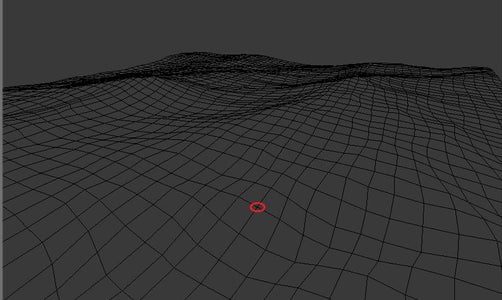

Step 6: The Buoy
For the buoy I used an 8” diameter expanded polystyrene ball which was “secured using wire to keep it firmly joined to the 5/8” tubes.
It hasn't still been tested in the sea, but to use it safely in there, use some electrical tape to isolate the coils. Then you can put some silicone to prevent it from losing its stickiness.
