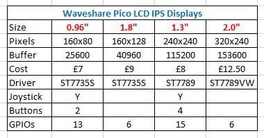

I own three other WaveShare Pico screens, all with fewer pixels. I usually add code to include a re-sizeable font. This is quite a large chunk of code and data, but very useful. (You can see it in use in some of my other Instructables.) If you look at the table you will notice that the display buffer needed to drive this display uses 153600 bytes. This uses so much of the available RAM that there is not enough room for the Font system. We are limited to text appearing in the single, rather small size. There is also much less room for our own code either. It means that we need to be careful not to be wasteful in our coding and to carry out garbage collection regularly, to save us from running out space.

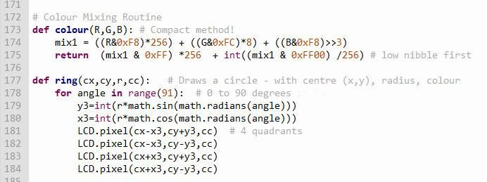

Different number bases are used all the time; denary, binary and hexadecimal. Colours are defined as red, green and blue components in denary (range 0 – 255) and converted from a 3 byte value to 2 bytes with binary shifting and masking - from set theory.
The circles are constructed with a series of concentric single pixel rings which are draw using trigonometry:radians, sine and cosine.
