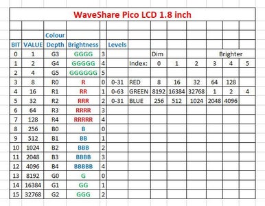

Step 2: So, What Colour Is 0x20FB?

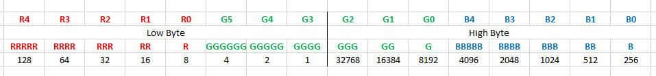

Most of us are familiar with 24-bit RGB colours represented by (255,255,255) with the first byte (8-bits) indicating the red brightness, the second the green brightness and the last the blue brightness. This means (0,255,0) is bright green and (255,0,255) is bright magenta. If we only have 2 bytes (16-bits) these are normally split 5-6-5 (R-G-B) because our eyes can are more sensitive to green.
If you look at the table the brightness of each colour is indicated by number of coloured letters. Red and blue have 0 - 31 levels of brightness and green has 0 - 63.
Adding the values of all the green bits and and the values of all the blue bits produces produces bright cyan and 0xFFFF indicates all bits are set and produces white. Two bytes in Hex is far harder to decipher and 0x20FB is orange.
Step 3: Another Way of Looking at the Numbers Producing a Colour
This may be easier to understand.

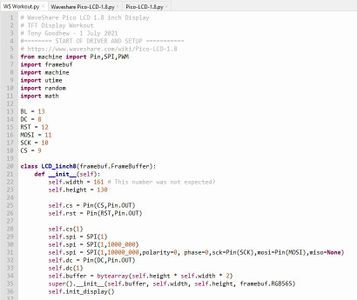

The documentation states that this display is 160 pixels wide and 128 pixels high. Normally the the top left pixel would be at (0,0) and the bottom right would be at (159,127). [ x = 0 to 159 and y = 0 to 127] Not with this display!
After experimenting by writing individual pixels to the screen I found that the top left pixel is at (1,1) and the bottom right pixel at(159,128) - only 159 pixels wide! [x = 1 to 159 and y = 1 to 128] - very odd!

Step 6: Program - Part 1
This is the top of the program showing the importation of the libraries and the start of the display setup sequence. The rest of the driver is very difficult to interpret and since it works can be taken at read.
The width and height numbers were unexpected. The back light can be controlled with PWM on GP13.

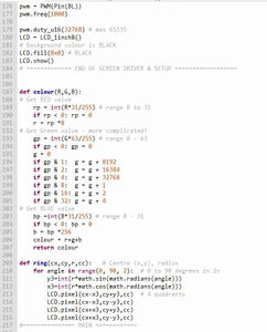

Step 7: Part 2
This shows the backlight setup and provides a couple of useful routines.
colour(R,G,B) converts 3 byte values to the 2 byte system used by this board.
ring(x,y,r,cc) draws circle of radius r centred on (x,y) in colour cc
ring(50,50,40,colour(255,0,0)) draws a red circle

Step 14: ​Driver Fixed by Waveshare – 10th July 2021
After uploading this Instructable I got in touch with Waveshare and pointed out the problem with the driver and supplied a test program writing to all four corners of the screen. All credit to them, they quickly got back to me with a series of updates for me to check out. Today I received a version which has the origin at (0,0), is 160 pixels wide and 128 pixels high. Problem fixed!
I’ve included the test program here, with the working driver.
