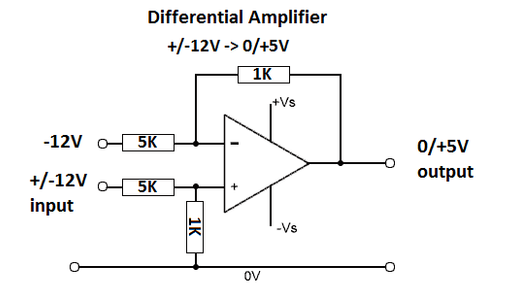

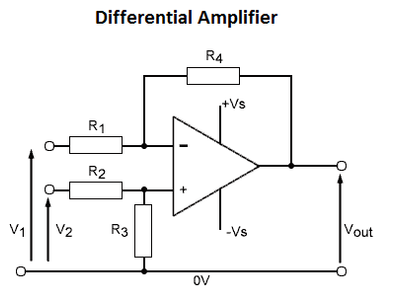

Here is where it comes my solution to the problem, which is different from those adopted by the mentioned projects: the use of a differential amplifier at the wave input.
A differential amplifier is a combination of both the inverting and the non-inverting amplifier. In it's most common configuration, the output is the difference between the two inputs, multiplied by the closed loop gain (see attached picture).
At this link HERE (electronicshub) you can take a look at all the math, in case you are interested. Empirical observations follow.

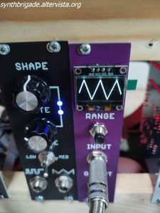

Attached are pictures of common input signals after the diferential amplifier "magic" I scoped with my full-featured oscilloscope. In particular, you can see an LFO triangle wave oscillating in the +/-2.6V range shifted to the +2V to +3V range, a 3340 oscillator square wave shifted from 0/+8V to +2.5V/+4V and two looped ADSR signals scaled to a range of +2.4/3.7V from 0/+5V (direct ADSR) and 1.5V/2.7V from 0/-5V (fully inverted ADSR).
The obvious compromise here is with resolution (20 mV @ +/-12V), but for a qualitative information it's more than acceptable (see attached video!).

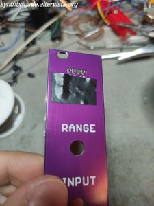

An important note about the OLED display: the same ID (SSD1306) is used for different OLED displays out there. There could be slight size differences (nothing to worry about), number of pins differences but also pinout differencies.
When you order your display from one of the usual online stores take care to get one with four pins, not seven. Four pins displays could differ in pinout, as said. This module is built around those with GND on the far left, by looking at the display area. There are versions with Vcc (+5V) at the far left instead. These latest are not compatible with the front panel PCB attached to this article and will likely burn and/or cause severe damage to your PSU if used (in the two different versions GND and VCC are swapped).
In any other shared module of mine I have suggested to order aluminum as base material for the front panel: the cost is the same as fiberglass but the strenght is higher. In this case it is not possible because of the need for some through-hole electrical connection between the main board, the panel board and the OLED display.
WARNING: Analuminum board in this face plate would not work!

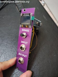

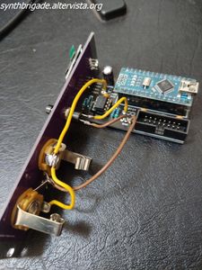

1) Assemble the main board first (see first picture). Components values are silk screeneed so a reference sheet is not necessary.
2) Solder the main board to the panel board
3) Cut all the main board protruding pins (in second picture I cut two only to show the difference)
4) Stick a small piece of isolating tape over the four pins
5) Solder your screen in place
6) Install all face plate elements (the button and the two jack connectors)
7) Solder face plate elements to the main board (don't forget ground cables!)
Points #3 and #4 are necessary to avoid short circuits between the main board and the OLED display. These are very close and could come in contact.
