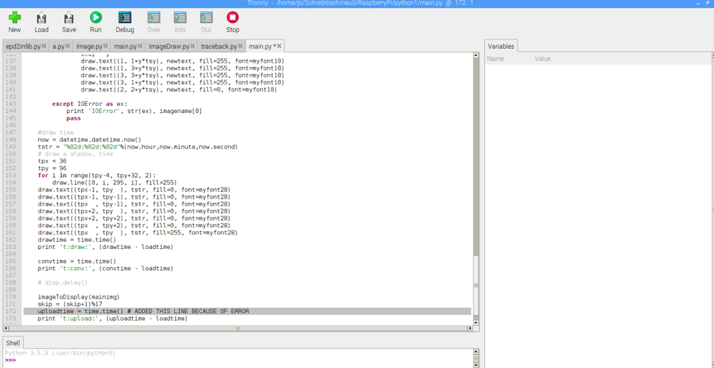

Reply 4 years ago
I commented in the 'print drawtime, convtime and uploadtime' but I got the error "uploadtime not defined" so I added the line "uploadtime = time.time()" then this error disappeared but the program still got stuck emitting search results eternally (with the draw-,conv-,uploadtimes being printed now). The display still shows no Image.
