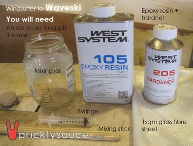

Step 1: Get the Bits Together
You will need...
An old windsurfer - I used an old classic Mistral Diamond Head
Epoxy resin + hardener
1sqm glass fibre cloth
Syringe for measuring the resin to hardnener
An old glass jar to mix the resin
A stick to mix
An old paint brush to apply the resin to the glass fibre
Some bits of off cut of ply for the footstrap pads, I used some 4mm and 18mm birch ply
Some bits of polystyrene
Mastic glue
Spray can if you want to make it look cool
TOOLS
Hand saw
Dremel type rotary tool
Router 1/4" or 1/2"
Screwdrivers

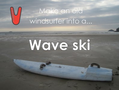

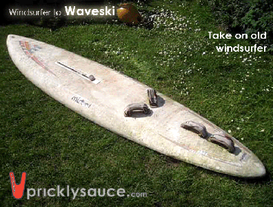

Step 2: Take an Old Windsurfer
A waveski is a cross between a surfboard and a sit on canoe and is played with in the surf, catching waves just like a surfboard.
I have always wanted one and I had an old windsurfer kicking around in the garden that hadn't been used for years...so instead of taking it to the recycling centre I gave it another life and it has given me another fun toy to play with!
A waveski has a thick blocky end with additional buoyancy to keep it on the wave, they also have two or three little fins like a surfboard.

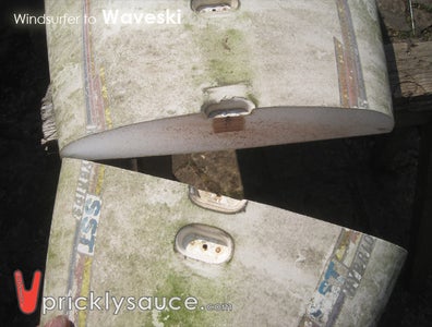

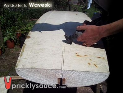

Cut the end of the windsurfer off with a handsaw at about 450mm in from the end.
In hindsight I would have made the waveski even shorter and would suggest taking another 300mm off.

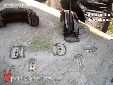

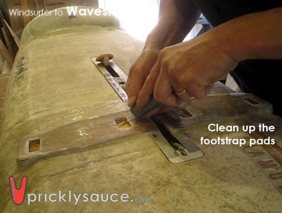

Remove the footstraps and the footstrap blocks if possible. Mine unscrewed and poped out with a flat headed screwdriver.

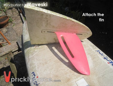

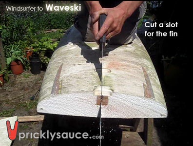

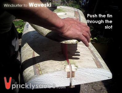

Fit the fin to the cut off end.

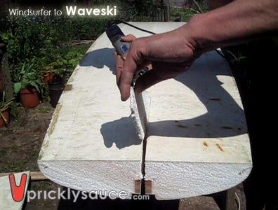

Mark and cut a slot into the end of the main bit of board and push fit the fin end through the slot.

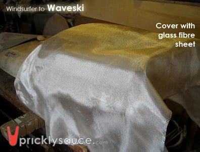

Step 3: Glass Fibre It Together

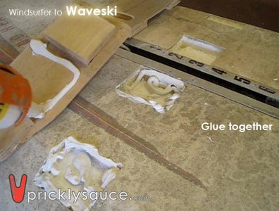

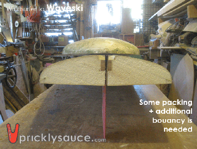

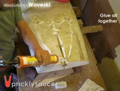

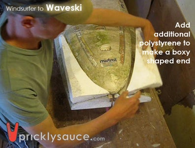

As a windsurfer is shaped with a rocker profile some wedges may be required to make the cut off fin end sit securely on top of the main board.
I cut some wedges of wood though polystyrene would work as well.
Cut some more of the polystyrene to fill out the blocky shape around the fin end.
Glue it all together with your choice of mastic glue.

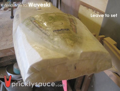

Take the glass fibre cloth and cut it so that it drapes over the end section and will tuck around onto the base of the board.
Mix up the epoxy resin as of the requirements on the manufacturers instructions.
Apply the resin to the glass fibre all over and around onto the base of the board.
Make sure the fibre overlaps around onto the board to make a good solid seal.
Leave to cure.

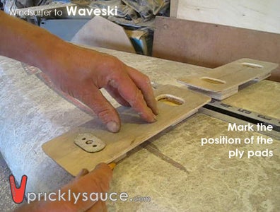

Step 4: Footstraps
A waveski has footstraps so that you don't fall off!
Check where you want them to be positioned with your knees bent.

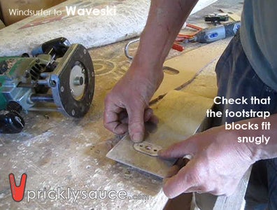

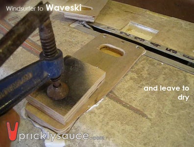

Cut some 4mm ply and glued on some 18mm ply blocks on the back side.

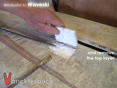

When dry router holes for the footstrap blocks to fit into, two per side.
Mark on the board where the bottom ply blocks will want to sit.

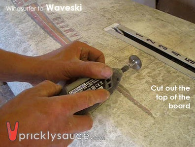

Cut the top layer of the board with a Dremel and prise the layer off.
Using the router increase the depth of the holes to accommodate the footstrap blocks.
Mastic glue it together and leave to dry.
With some off cuts of glass fibre cloth, resin the new footstrap blocks to the board.
When dry cut out the top of the four holes and check the fit of the original footstrap blocks.

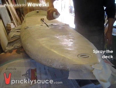

Step 5: Make It Look Good
You are making a cool waveski so why not make it look cool as well!

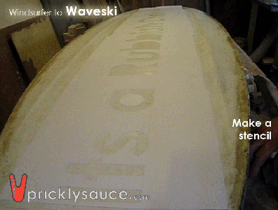

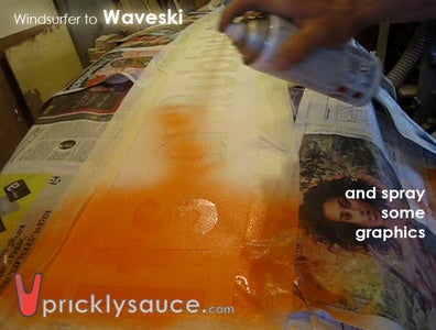

I made up a stencil and spray painted 'Its a Rubbish Challenge' along the bottom of the board.
I spray painted the top white to cover up the cut up end. I think I will add some more funky graphics to the top.
Screw the original footstrap blocks into place and then screw back the footstraps.
