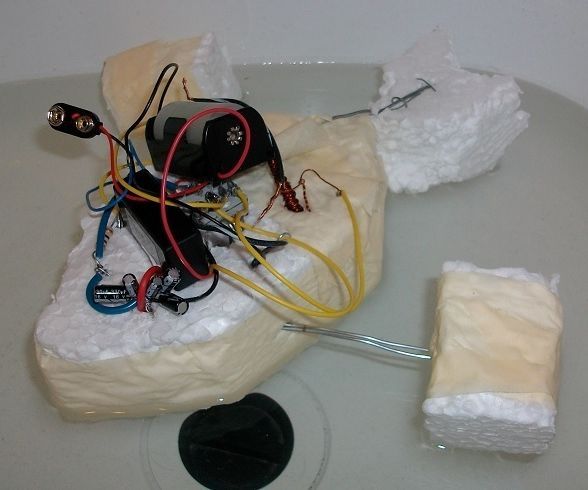

I constructed the circuit shown in the first photo. You can also implement this control system with MOSFETs. However, MOSFET transistors are hard to find in old electronic circuits. The link the to article about MOSFET motor driver on Hack a Day website is:

Step 3: Attach Motor to Board
This motor was taken from an old video cassette recorder (VCR).
This is why you need a high power wire, for the plastic tube that you attach to the motor rotor as shown in the first video.
