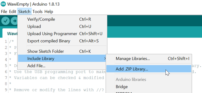

Step 4: Add the WawiLib Libraries to the Arduino IDE.
  • Fill in the location of the libraries identified in the previous step.
  • Select WawiSerialUsb.zip as the library to be installed.

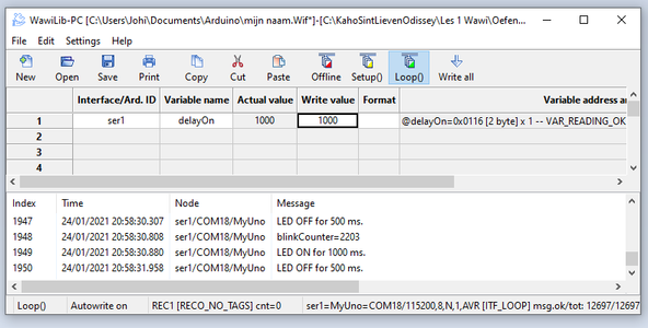

Step 8: Add a Variable to Display.
  • Add the variable delayOn in the "Variable name" column.
  • WawiLib should show the actual values of the delayOn, delayOff and blinkCounter.

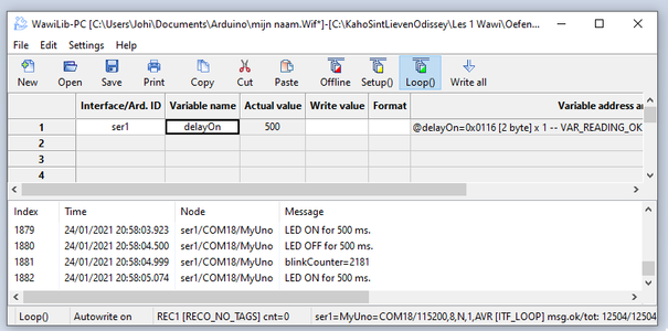

Step 9: Write a New Value to DelayOn.
  • Fill a new target value for delayOn, in the "Write value" column.
  • Press "Write All" to write the new value in delayOn.
Note: To enable "AutoWrite" = "Enter key" after write in "Write variable column" triggers write.
