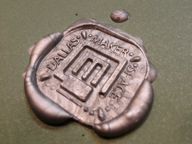

Introduction: Wax Seals From a Laser Cutter
Last week, I was fiddling with the packaging for Laser Lace Letters, and nothing quite seemed right. It's a victorian steampunk project, with stories told through letters and other documents, so I started asking my friends what they thought of when they heard the words "Victorian mail."
"Wax seals!" they all said.
"But didn't wax seals go out of fashion with the rise of the postal service, around before the Victorian period?" I said.
"Doesn't your story involve tiny robot swarms, evil laser cutters and Aether travel?" they said.
"Oh," I said.

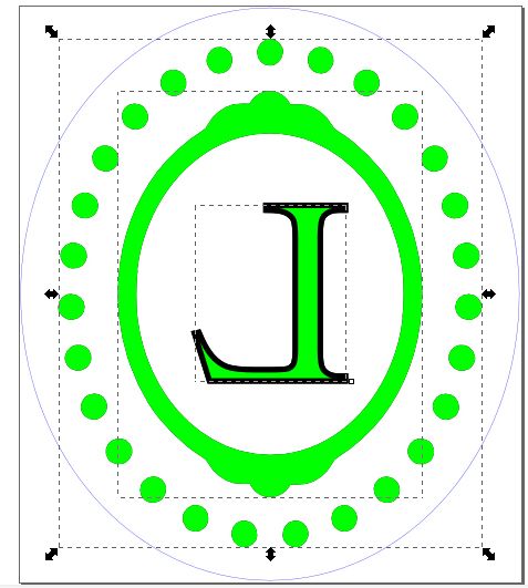

- The easiest way to get your art to cut correctly on the laser is to make it in Inkscape or another vector drawing program. You'll be able to draw your cut line on the same canvas as your art. This makes it easy to center.
- Your art should be in black and white. The black areas will be raised in the impression.
- Make the cutting outline of your stamp smooth; circles and ovals work best. Some historic seals are in the shape of a pointed oval, too.
- Leave some room at the edges of the design. Seals work better if the edge of the matrix is smooth.
- When you have your design finished, you must flip your art horizontally. The process of leaving an impression in the wax will flip it back.

Step 2: A Tricky Gray Area (Optional)
The laser cutter will be rastering your art, and then cutting out your matrix piece. If we laser a shallow edge around the art, the wax will press into it more easily, and will be less likely to get stuck. It involves some complicated work in Inkscape - and it's worth it - but if this is your first seal, I won't blame you for not wanting to spend time on this.

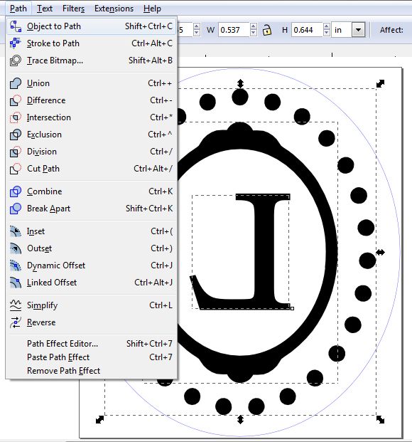

1. Convert your art to paths
![](https://content.instructables.com/FU4/57V5/H6S41EJC/FU457V5H6S41EJC.jpg?auto=webp&fit=bounds&frame=1&height=620&width=620)
2. Make a duplicate of your art.
![](https://content.instructables.com/FL5/LNDZ/H6S41EJD/FL5LNDZH6S41EJD.jpg?auto=webp&fit=bounds&frame=1&height=620&width=620)
Select all of the art inside your design (not the cut line on the outside) and duplicate it with Ctrl-D. Set this copy to a different fill color, so you can tell the two copies apart.

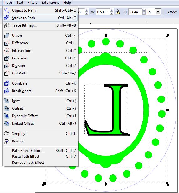

3. Convert any strokes to paths.
![](https://content.instructables.com/F6C/0MDY/H6S41EJE/F6C0MDYH6S41EJE.jpg?auto=webp&fit=bounds&frame=1&height=620&width=620)

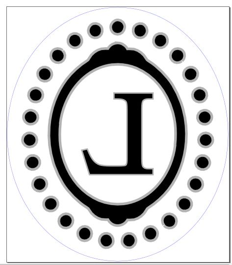

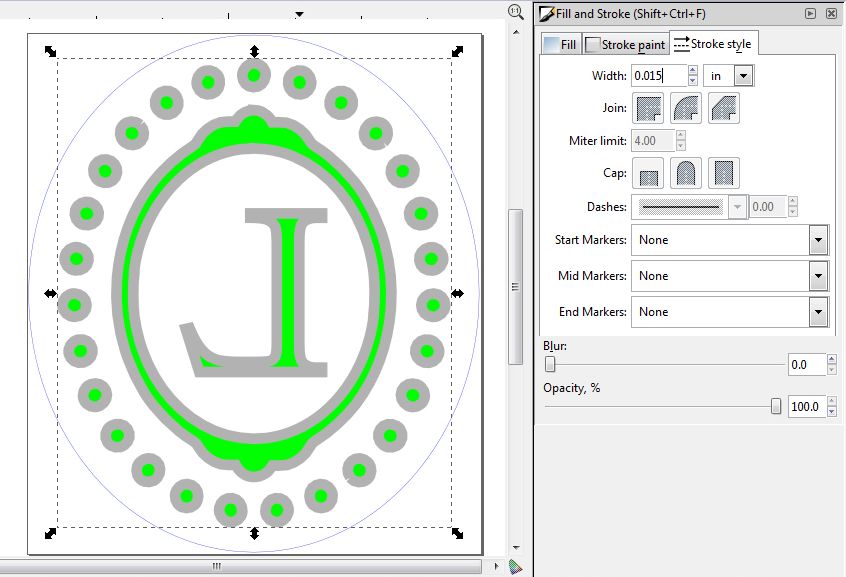

4. Add a thick gray stroke.
![](https://content.instructables.com/FSX/NF2H/H6S41EJG/FSXNF2HH6S41EJG.jpg?auto=webp&fit=bounds&frame=1&height=620&width=620)
Group (Ctrl-G) or combine (Ctrl-K) the copied art and give it a thick, light gray stroke. .015 inches is a good width, and 30% gray is a good color.
5. Send to back
![](https://content.instructables.com/F33/G9FC/H6S41EJH/F33G9FCH6S41EJH.jpg?auto=webp&fit=bounds&frame=1&height=620&width=620)
Send the copied art to the bottom of the drawing. Your black artwork will now have a gray halo around it that the laser will raster as a shallow lip.

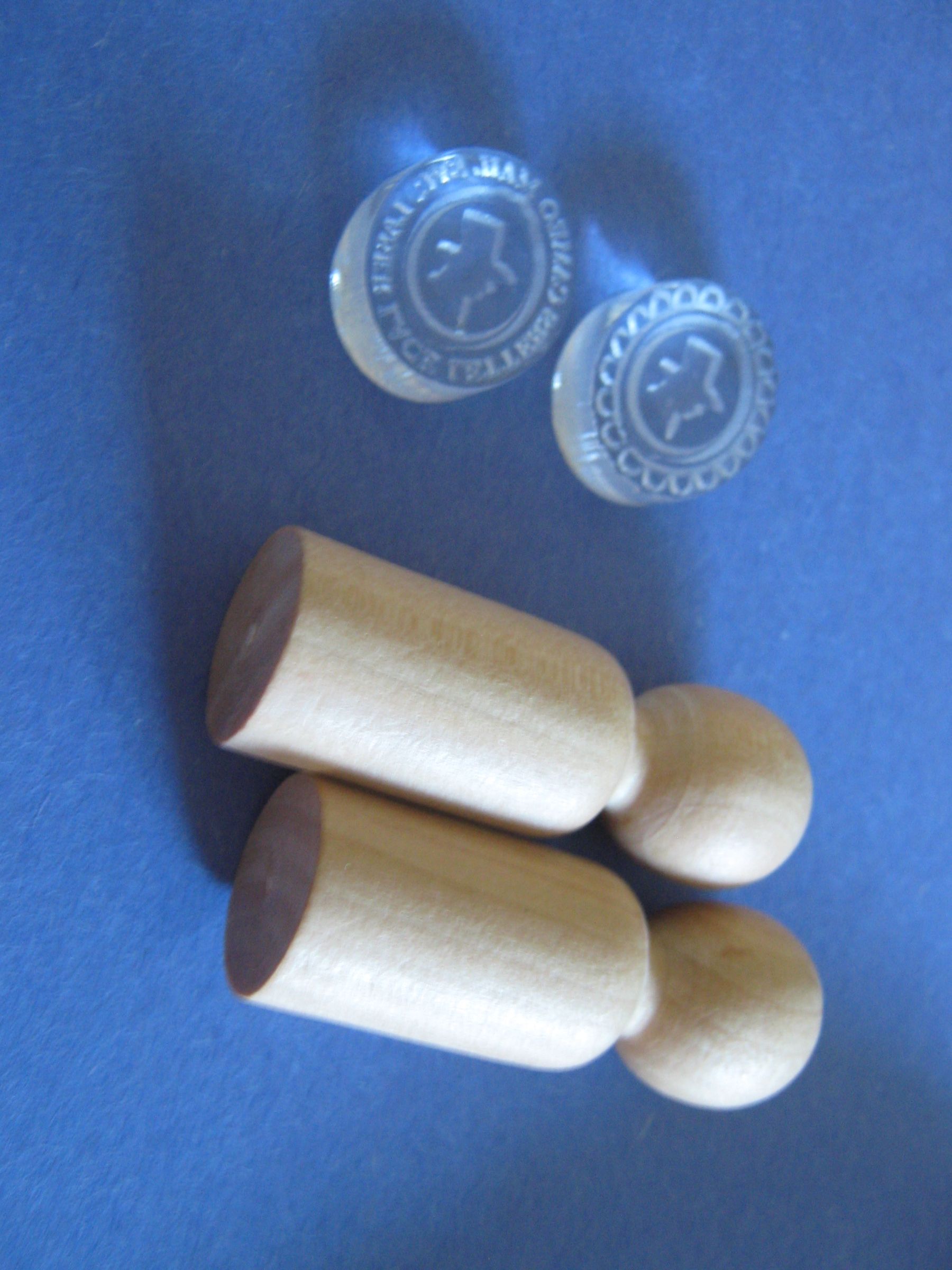

Step 4: Attach the Matrix to a Handle
A handle will make the seal easier to place and to get out of the wax. Check out the woodworking area of your local craft store for things that make good handles.
Pegs and wooden board game pieces make really great looking handles, but you can also use a cork, a bobbin, or any other item that has a flat bottom no larger than the width of your matrix.
![](https://content.instructables.com/FZ1/1IG4/H6S41EXZ/FZ11IG4H6S41EXZ.jpg?auto=webp&fit=bounds&frame=1&height=620&width=620)

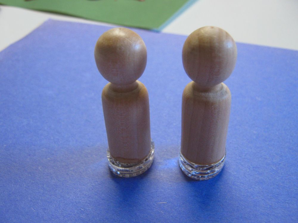

For this instructable, I'm using these wooden "peg people" game pieces. These come from Michaels, but you can also get them online for fairly cheap.

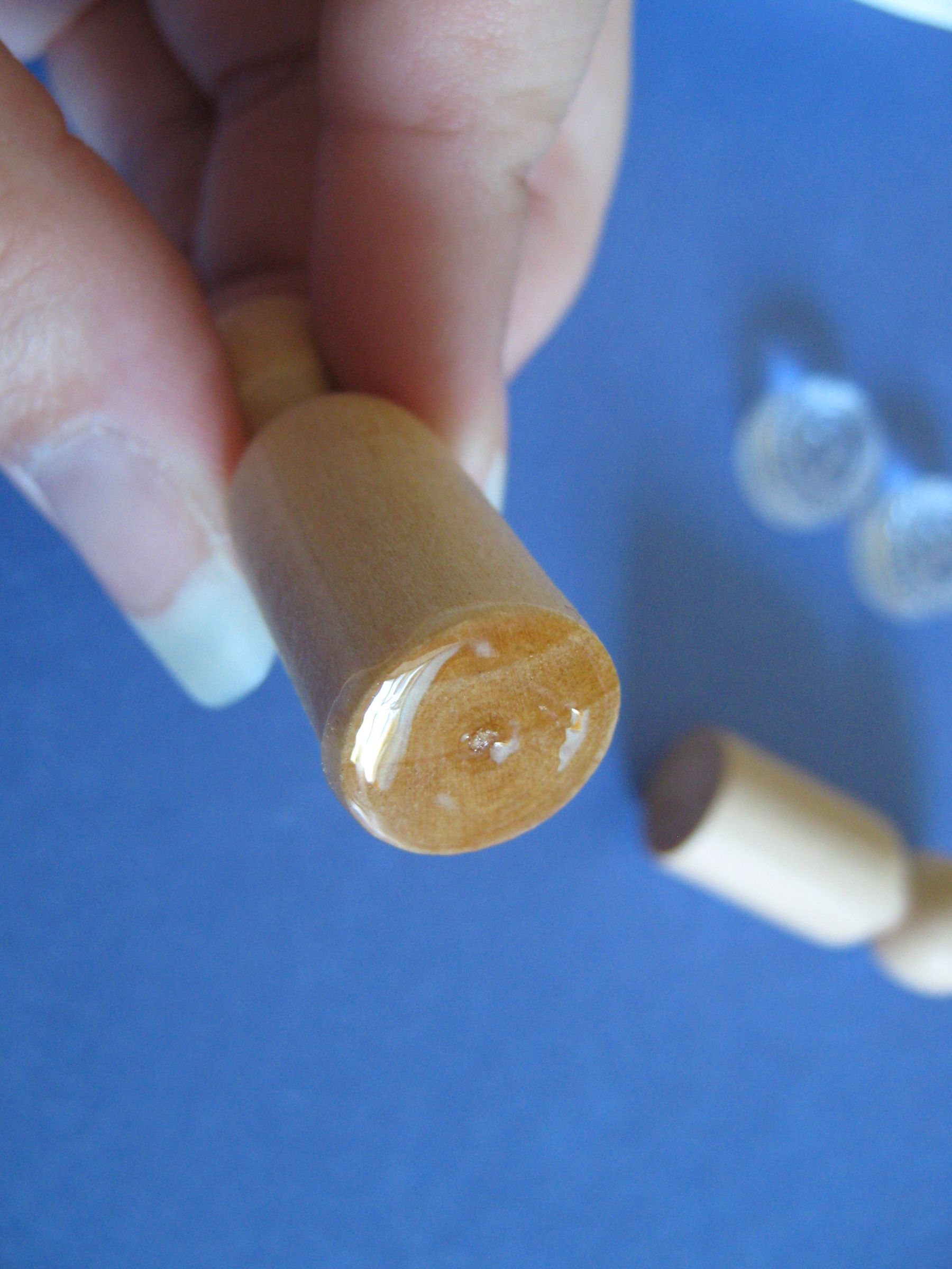

Pick a glue that will bond well to both the acrylic and the handle; it will need to withstand quite a bit of pulling as you take the matrix out of the wax, and will need to be able to handle getting warm as well. Cyanoacrylate glue (such as Krazy glue) won't work well, since the wood will absorb it. I used Gorilla Epoxy, which has a 30-minute cure time and dries clear. I also like JB Kwik for bonding acrylic to wood, but it is gray-black instead of clear, and harder to work with in small batches.
![](https://content.instructables.com/FMF/UD8Y/H6S41EY0/FMFUD8YH6S41EY0.jpg?auto=webp&fit=bounds&frame=1&height=620&width=620)
Put a dab of epoxy glue on the flat end of your handle.
![](https://content.instructables.com/FTV/645R/H6S41F67/FTV645RH6S41F67.jpg?auto=webp&fit=bounds&frame=1&height=620&width=620)

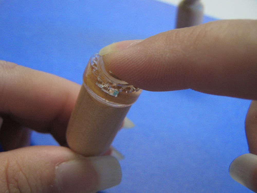

Place your matrix on top (with the engraved side up) and center it by pressing down and sliding from side to side.
![](https://content.instructables.com/FP7/6Q3U/H6S41F65/FP76Q3UH6S41F65.jpg?auto=webp&fit=bounds&frame=1&height=620&width=620)
Carefully flip the piece over and set it engraved side-down to cure. Wait for the glue to cure completely before making your first impression.

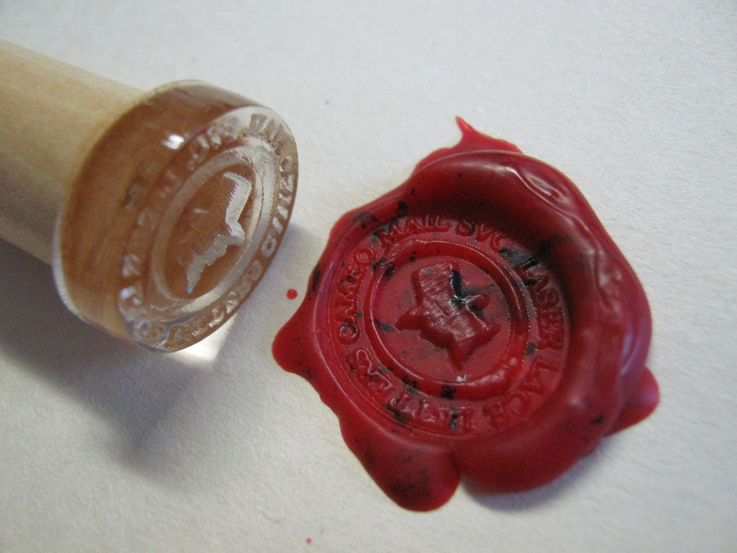

Step 5: Making a Good Impression
Sealing Wax comes in many varieties and colors. For this Instructable, I'm using a traditional wicked stick, which is similar to a candle, because that's what I could find locally. This is probably the least desirable method for getting your wax onto the paper; it takes a long time to drip the wax, leaving an uneven pour.
Online, you can find a larger variety of types of wax. There are sticks that fit into a low-melt hot glue gun, beads that you melt in a spoon or a melting pot, and wickless sticks that you heat with a heat gun. Wax also comes in a wide range of colors, and occasionally, scents.
In any case, the method for making a wax impression is pretty much the same as you'd use to make one with a metal matrix.
![](https://content.instructables.com/FKI/YL6W/H6S41K0P/FKIYL6WH6S41K0P.jpg?auto=webp&fit=bounds&frame=1&height=620&width=620)

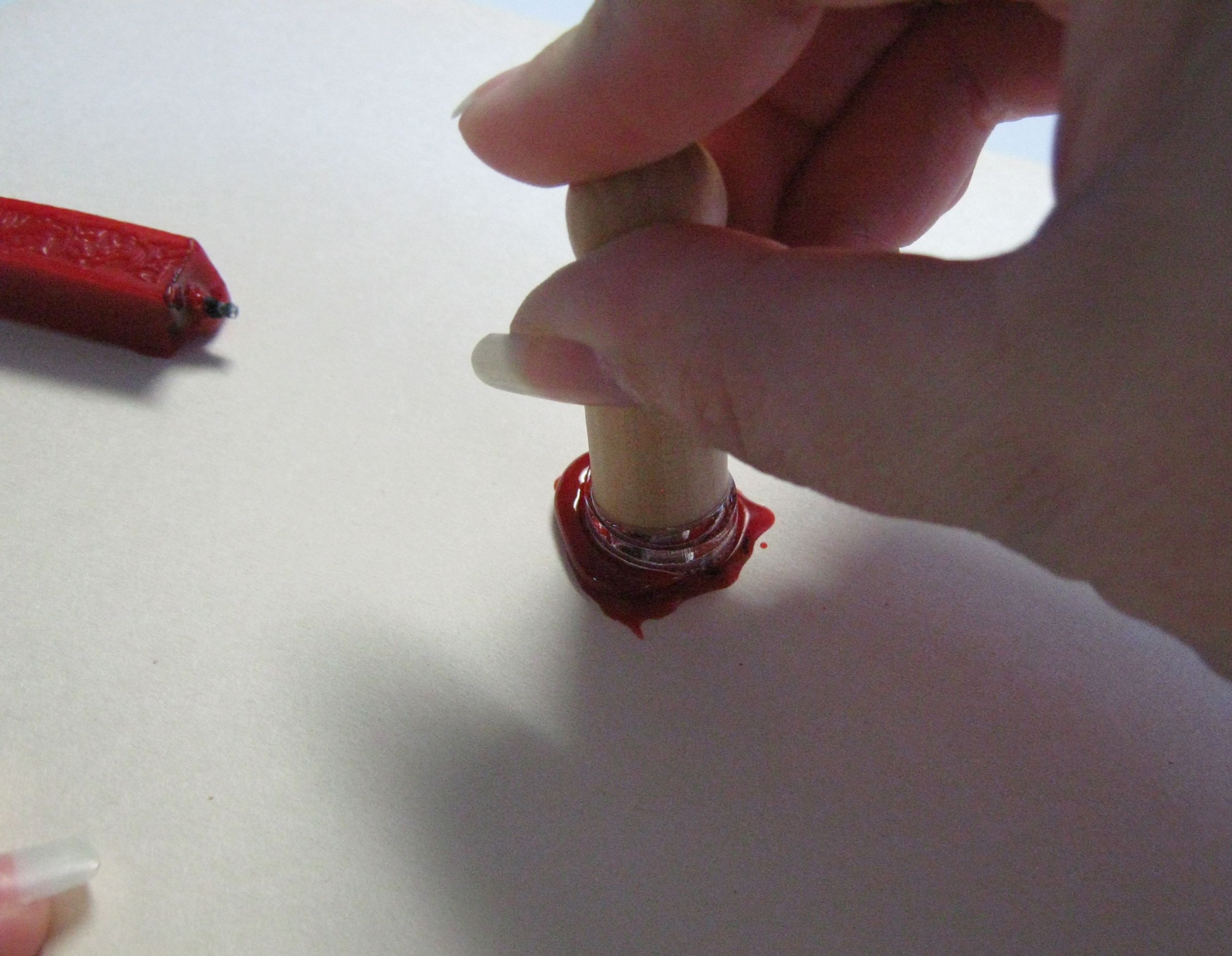

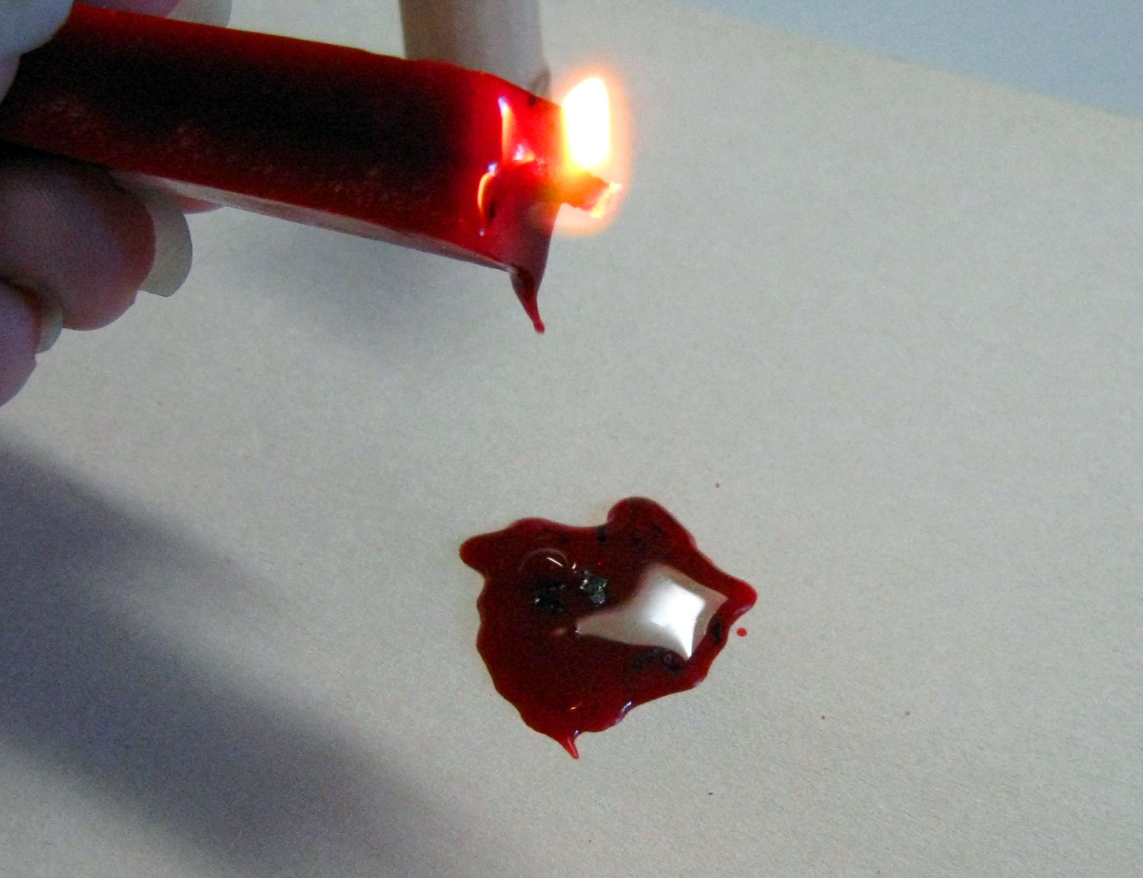

Melt your wax onto the paper. Cover an area slightly larger than the footprint of your matrix.
![](https://content.instructables.com/FHO/5OXH/H6S41JZ7/FHO5OXHH6S41JZ7.jpg?auto=webp&fit=bounds&frame=1&height=620&width=620)
Wait 5-10 seconds for the wax to cool, then press your matrix firmly down into the wax.
![](https://content.instructables.com/FL5/09DE/H6S41K0O/FL509DEH6S41K0O.jpg?auto=webp&fit=bounds&frame=1&height=620&width=620)

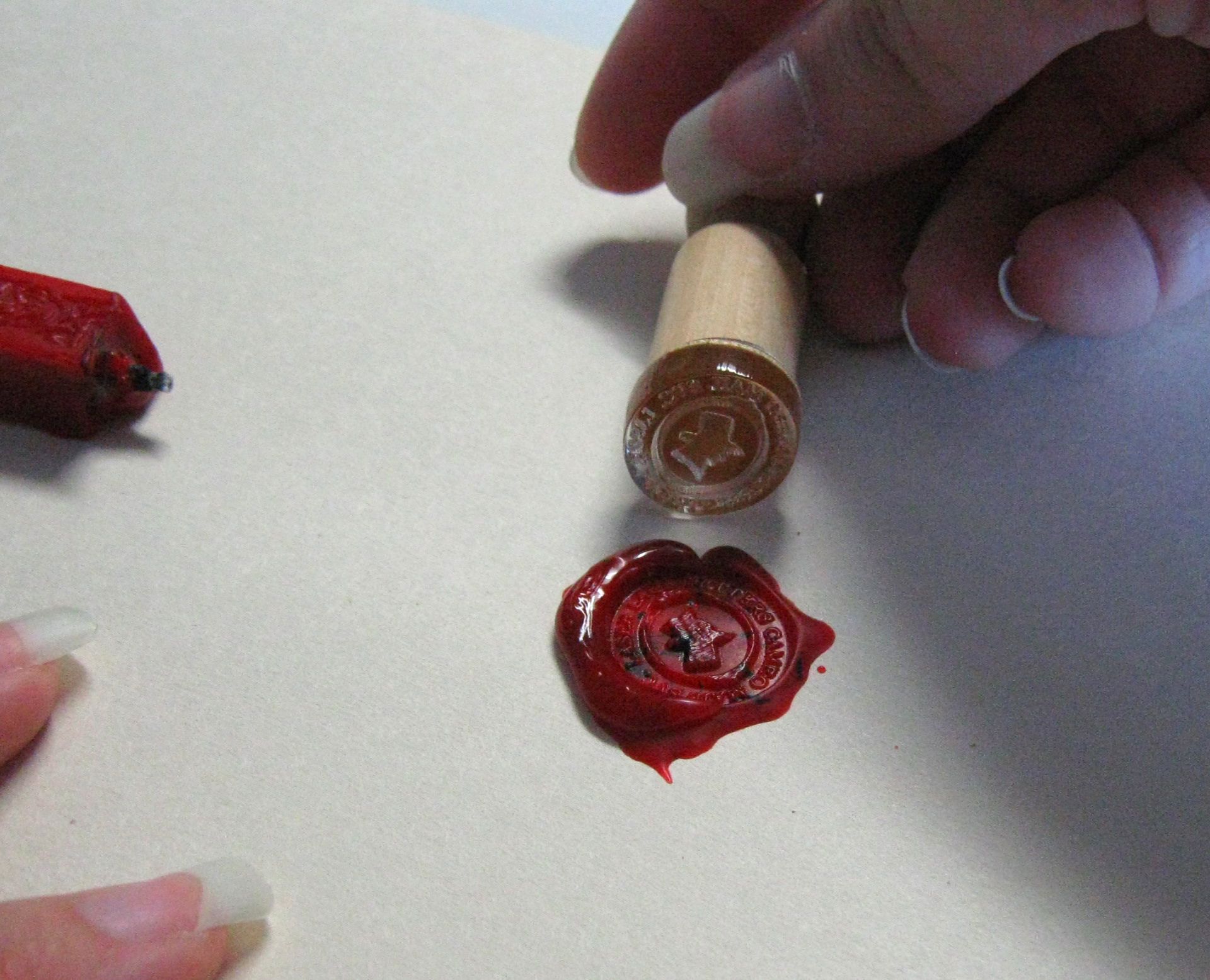

When the top of the wax begins to cloud over, remove the matrix by gently rocking it back and forth until it comes free.
![](https://content.instructables.com/FKK/EY7R/H6S41JZ6/FKKEY7RH6S41JZ6.jpg?auto=webp&fit=bounds&frame=1&height=620&width=620)
The other undesirable thing about wicked sealing wax is that if you don't pay attention, you can easily burn the wax, which will leave these black flecks in your seal.
