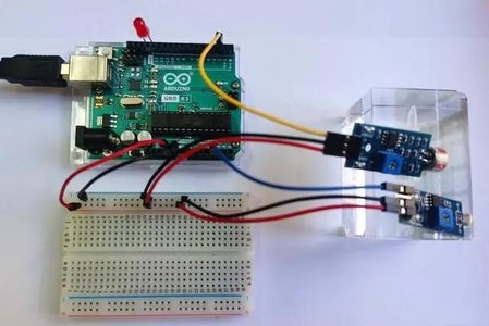

Step 1: Experimental Equipment and Circuit Connection
First, insert the long leg of the LED into pin 13 and the short leg into the GND ground pin; then connect the 5V and GND of the Arduino to the edge slots of the breadboard (marked in red and blue), and then use the DuPont line to connect the VCC positive pole and GND ground of the sound sensor and light sensor to the breadboard; then connect the OUT signal output of the sound sensor to the digital pin 2 of the Arduino, and the AO analog signal output of the light sensor to the A2 analog pin of the Arduino; finally, connect the Arduino to the USB port of the computer via a data cable.

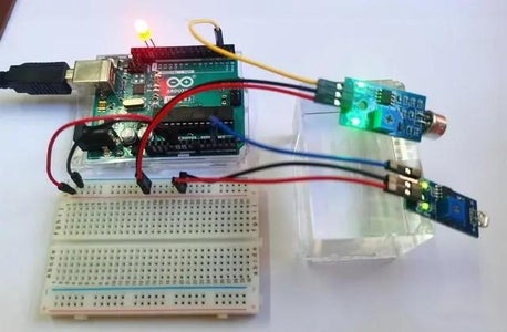

Test the sound and light dual-control lamp: When the indoor light is in normal lighting state, no matter how loud the music is in the speaker, the LED light will not light up; if you cover the light sensor with your hand and play music at this time, the LED light will light up (as shown in the picture). Similarly, when the light sensor is covered and the surrounding environment is kept in a relatively quiet state, the LED light will not light up

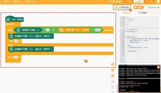

Step 5: Mind+ Graphical Programming Realizes "sound and Light Dual Control Lamp"
Run Mind+ to enter the graphical programming interface, and combine the "building block" statements according to the code programming structure just now. The most critical thing is to build the judgment condition in the "if...otherwise..." selection branch. It is also to judge whether the two conditions that the sound sensor monitoring data connected to the No. 2 digital pin is 0 and the light sensor monitoring data connected to the A2 analog pin is greater than or equal to 500 are met at the same time. If it is true, the LED light is controlled to light up for 5 seconds, otherwise it is controlled to keep the LED light off (as shown in the figure).
Click the "Upload to Device" item, and after the "Upload Successful" prompt appears, test the Arduino's "sound and light dual control lamp" again, and the effect is still the same as using code programming.
