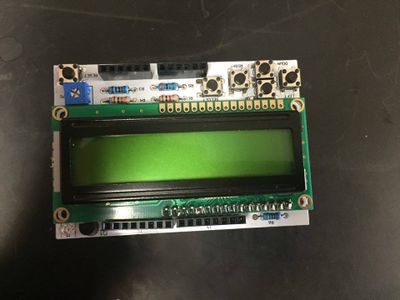

Step 5: Step 5: Adding Detachable Components (LCD Screen, SD Card)
In order to readout your temperature readings in real-time without using a computer, an LCD screen can be used. With this screen, you can see the temperature readout of your device at any time throughout the day.
To save the readings of your IR thermometer, you can use a microSD card in collaboration with a microSD shield. With these components, you can later read out the temperature measurements of your device, and monitor the changes in temperature over the course of a day, a week, or longer.
To incorporate the LCD screen and microSD, the components can be integrated with the Arduino. To do this, first connect the LCD screen to the micro SD shield via the normal-orientation pin holes. Then, connect the microSD shield, with SD card inserted, to the Arduino Uno. In this way both the SD shield and the LCD screen will receive input from the Arduino.
