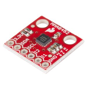

- SparkFun Triple Axis Accelerometer Breakout - MMA8452Q

I used a MMA8542Q Triple-axis accelerometer from Sparkfun which uses the I2C communication protocol to talk to the Raspberry Pi GPIO pins and send the axes data. This sensor provides various modes of operation with the configurable data rate, sleep modes, acceleration range, filter mode, etc. I found the code from Pibits to be very helpful in my initial configuration of the sensor and testing it out with my hand gestures. It is better to first place the sensor on a flat surface and make deterministic tilts while observing the raw sensor values. This is particularly useful in understanding how this sensor reacts with various hand gestures and how we can set up thresholds for our application. Once the accelerometer is succesfully interfaced, you can see the raw axes data coming on the Pi's terminal screen.
