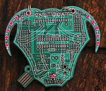

Originally, I wanted to get my currency laser cut out of stainless steel, but this would have been very expensive so I had to think of a cheap and effective way of achieving the same end result. Fine if I had my own 3D printer! (But I don't). I made some PCBs about a year ago and they worked really well, were cheap to make and looked totally awesome so I thought: 'Why not make my currency on PCBs?'
I have now made my own currency, or note/tokens, as I need seasonal workers in the spring to help me plant and weed vegetables which then get harvested in the summer. autumn and winter. I have used PCB circuit boards as the format and designed them to be primarily a currency, but also an interesting object to wear as a pendant and even to produce electronic projects! (Yes, they are fully functional PCBs with USB, ATMEGA and ATTINY85-20SU chips, LEDs, mini speaker, 20 x 4 LCD, power regulator and hackable tracks/pins). And just to top it off ........ They are plated with real gold!

The note/token must be of a sufficiently complex design so that it is difficult to copy and should not be symmetrical or have obvious geometric patterns. This can be achieved by having lots of complex artwork, holes drilled in it and even chips soldered on containing serial numbers etc. There are also hundreds of small errors included so that it makes it hard for the potential forger to copy it easily. The drill holes are really useful as you can quickly line them all up to see if it is a forgery or not.
The token should look plausible, that enough work and attention to detail has been done to give people faith in the product. I've made my tokens multi functional as well, so they are wearable, can be made to be musical or activate flashing LEDs etc.

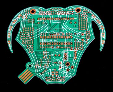

Step 4: Making a PCB (Printed Circuit Board)
There are a few very good bits of software that can be obtained for free, for example, Eagle and Design Spark. Making PCBs is fairly easy and the software is very intuitive. Here are 14 key points to understand, listed below:
  1. Copper Pour - after the circuit tracks are laid down, the rest of the board is covered with copper using the copper pour command.
  2. Isolated copper pour islands - Big areas of isolated copper can act as capacitors and have very undesirable effects on the electronic performance. Always provide links to ground.
  3. Double sided - These boards will be smaller and the connections much stronger than single sided boards, where the tracks tend to readily separate from the board itself.
  4. Copper Pour area - The area within the board where you want copper poured needs to be marked out with a box on each layer of the board. I generally use 2 layers, top and bottom.
  5. Ground - Label everything connected to ground with the same net name eg 'GROUND'. This way, when you do the copper pour, all the grounds will be connected when you select the appropriate option.
  6. Vias - These are copper encased holes that can be used to connect a circuit on the top of the board to one on the bottom. Can also join top and bottom copper pour areas very nicely. Very useful!
  7. SMT - Can you solder very small components? There are some excellent tutorials for soldering on Youtube.
  8. Heat sensitive components - LEDs and power regulators will get warm or even hot during use so use heat sinks/fans and separate hot components from heat sensitive ones. Circuit boards may even crack due to heat so in these cases consider using expansion gaps, or slots in the board.
  9. Track size - wide tracks for power, narrow ones for signals.
  10. Documentation layer - This does not get printed on the board and is for reference only.
  11. Gerber files - You need to create this set of files in the software output. It's easy! Send these to your manufacturer.
  12. Manufacturers - These are almost exclusively in China and the company I have dealt with Sitopway, is very reliable and helpful. Don't be intimidated by ordering from China - it's totally cool! Remember, China shuts down for 10 days during the Spring Festival around the Chinese new year, the dates of which change from year to year!
  13. Check your boards before ordering. Check them again. Keep checking them over and over again. You WILL find mistakes!
  14. Order a small initial batch of 10 to check the boards are ok before ordering a full batch.
If anybody can think of anymore useful tips please use the comments box below and I will add them to this list.
