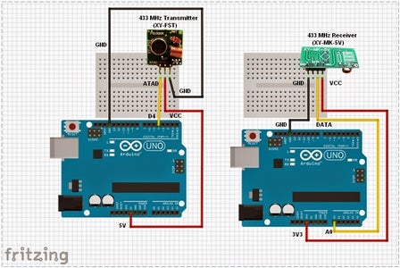

Step 1: Transmitter and Receiver Set Up

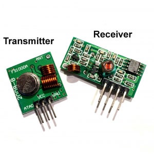

Assemble the transmitter and receiver modules making sure they are connected correctly to the positive and negative power supplies as well as pins for data both on the module end and on the Arduino end which is set within the code. ( note that modules require VirtualWire library).
Make sure the the transmitter and receiver are sending and receiving data by transmitting a string of text or any characters (note they will need an antenna soldered onto the modules both of which are pretty directional and distance sensitive).

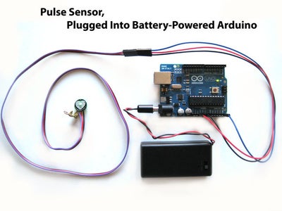

Step 2: Pulse Sensor Setup
Once we have the transmitters working it's time to move on to the actual pulsesensor it's setup is pretty simple and the creators over at http://pulsesensor.com/products/pulse-sensor-amped have a much better getting started write ups and videos on setting up the sensor and having it run in no time.

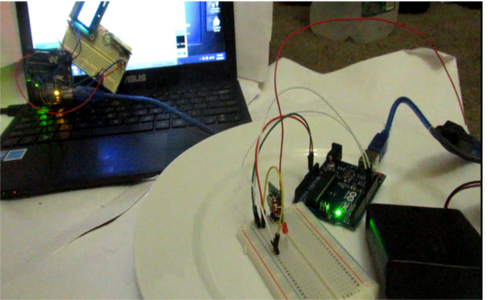

Step 3: Combining the Pulse Sensor and Transmitter Receiver Modules

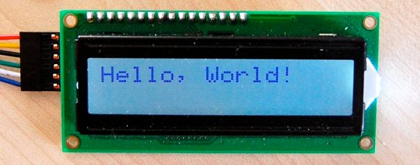

Once we are sure that both our transmitter and receiver are working as well as the Pulse sensor reading pulse data to it's respective arduino, we combine the transmitter and the pulse sensor in order to send the information over wirelessly towards the receiver module. The receiver module then takes this information and displays it on the arduino which it is connected to on an LCD display (in order to get the LCD to display the LiquidCrystal_I2C, and the Wire libraries must be downloaded and imported into the receiver's arduino code). Once we have everything assembled we want to check and make sure that the code and circuit are reading the pulse transmitting it, the receiver then receiving the pulse and displaying it on the screen.
