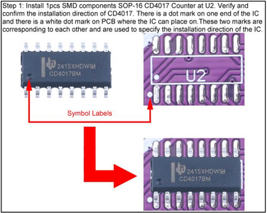

Step 1: Install 1pc SMD Components SOP-16 CD4017 Counter at U2
Install 1pc SMD Components SOP-16 CD4017 Counter At U2
Step 2: Randomly Choose a Pad on the Pcb and Then Melt the Solder
Step 3: Fix CD4017
Step 4: Fix Others Pad on CD4017

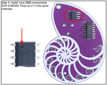

Step 5: Install 1pc SMD Components SOP-8 NE555 Timer at U1
