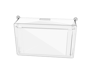

Step 5: Data Acquisition Module Enclosure
Attached are the two .STL files to 3D print the cover panel and main enclosure. The cover slides on top of the enclosure to protect the electronics inside. Large cutouts on the exterior of the enclosure allows connections and access to the micro SD card, sensor header connections, FTDI connection and micro USB port for charging.
Since this was my first prototype and first 3D model created in SolidWorks, the location of the screw holes on the interior of the enclosure was not placed in the right position. They were suppose to provide a location to fix the PCB board onto the enclosure, however they were too close to the corners of the PCB to be drilled. The PCB board is also slightly smaller than the interior of the enclosure, so it slightly rattles inside the enclosure since it is not screwed down. Further adjustments to the enclosure design can be modified in the future.
STEP 1:
Print out model using a 3D printer.
STEP 2:
Clean off 3D printed support material using water jet.
STEP 3:
Place PCB Board Inside enclosure
STEP 4:
Slide in Elastic band sewed with velcro into the slot on the back of the enclosure.
