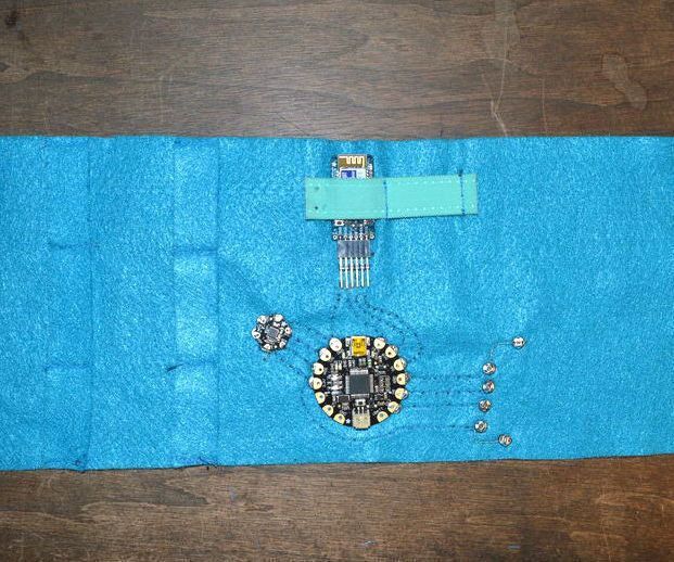

This band builds off of an original prototype I designed in 2014. The new band is extremely modular and allows for several different sensors and feedback components to be interchanged using snaps. The prototyping patch is small enough to fit on a female forearm and comes with adjustable elastic bands so that it can be placed anywhere on the body. The entire kit can be seen above, but this set of instructions will focus only on the main patch shown in the 2nd picture.
What can this patch work with?

Step 1: Make a Paper Prototype and Cut Out the Base Fabric
Make Paper Prototype
Even if you are building this exactly as I did, I still recommend drafting it out on paper first. It's very useful to have a quick, non-digital reference as you're building. To do this, trace the components on the paper and draw out your connections. As you can see in the image the connections cannot cross. This patch uses conductive thread, which is like using exposed wire.

Step 3: Solder Snaps and Modify the Breakout Board
Solder Snaps
Before you move on with the base patch, you'll need to solder snaps onto your microcontroller, sensors, and feedback components. Wearable sensors are pretty easy because the I/Os are intentionally spread out. If you're planning to use sensors that are not designated as "wearable," you'll have to get a little creative. Most sensors come with solder points for male leads. I recommend soldering the male leads in and bending them outward like a fan. This gives some space for snaps. Look at the absolute orientation sensor and the gain sensor as examples.
Modify Photon Breakout Board
To use the SparkFun Thing ESP8266 for this wearable application, I had to get creative. There is not yet a wearable breakout board for this mircocontroller, so I modified the Photon breakout board to fit my needs. The SparkFun Thing has 20 pins and the Photon has 24. I placed the SparkFun Thing in the center of the Photon breakout board, leaving an extra female input port on each side. You'll also notice that the Photon is narrower than the Sparkfun Thing, which means the SparkFun thing will not fit without modification. To make it work, do the following:
