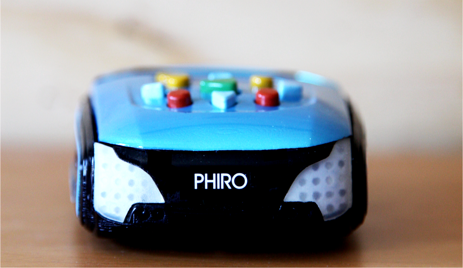

You can have a look at the pictures we used for our program. They were inspired by Darth Vader's chest panel (sort of). Make sure PHIRO Pro is on Mode 3 (Bluetooth Mode - press the Mode button on PHIRO till BLUE LED near the display on top turns ON.)
