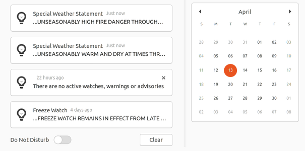

When you're planting a garden there is one important thing easy to forget - severe weather reports including frost on your crops. I noted there was a little red (!) alert icon on an Android weather widget, but there seems to be no such alert for desktop computer or Linux computer or phone. I made a simple script that should help, documented here

If there is an alert you should see it in notifications.
