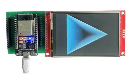

The parts required can be bought as a three-part-set, as in the photo above.
Comprising of ESP32 microcontroller, 3.5" TFT screen and a pcb which connects the two together. This is by far the best option. The boards just fit together without any additional steps. No additional parts are required. Price of November 2025 was £14

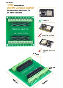

ESP32 board & screw-terminal expansion board
ESP-WROOM-32 ESP32-S Development Board Type C ESP32 Bluetooth Wifi ESP32 Nodemcu Bluetooth Module + ESP32 Breakout Board - AliExpress 502

This is simple, just plug the ESP32 board into the pcb and then do the same with the TFT screen BUT ensure you put them in the right way round, else damage could easily occur.
Referring to the photo above, plug the TFT into the green PCB. Ensure the green pcb is the correct way around. It has two holes drilled in it, which should align with the holes on the TFT pcb.
The legends printed on the pcb should match those on the TFT.
The ESP32 can now be placed onto the centre two connector rows.
Again, the legends on the pcb and ESP32 should line up.
Take care when inserting the boards, to ensure no pins are bent.

If you are not using the 3-part set, the ESP32 and TFT board can be connected using suitable wires.
If using a bare ESP board, you will need to use Dupont wires. However these do not fit tightly, so I would suggest hot gluing them in position once the project is finished.
If using the screw-terminal e
The JST XH connector has a tighter grip, so should not come loose.
