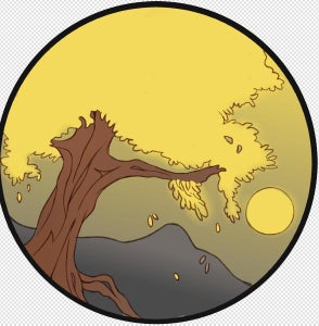

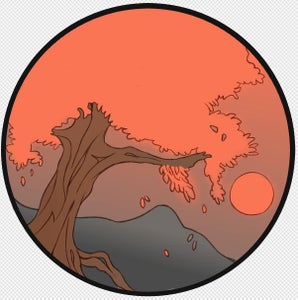

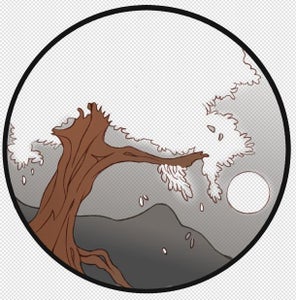

Step 4: 3D Printing and Laser Cutting & Engraving
If you open each of these files below one at a time one in photoshop (the .ai) for the laser cutting, and the other (.stl) in any 3D CAD software that can be sent to a 3D printer.
For the Graphic you need to engrave the .ai file first onto the bamboo at a 23cm radius. i have attached the settings i edited.
