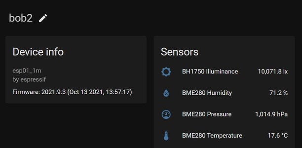

Then in Home Assistant install ESPHome from the Addon Store. Open up the Web UI and click on the green + at the bottom right. Next name the board, mine's "bob5" and enter your wifi details for it to connect to. The WeMos is a ESP8266 so select that one. Next click on the three dots and select manual download, this will compile the code, save the file when ready mine's bob5.bin. Then plug the WeMos into your computer via USB, select the Serial port for that device and open the file (bob5.bin). Click Flash ESP and it will install the code onto the WeMos. Now your Home Assistant can see bob5 on the network as a device and is ready to start being useful.

The Wemos board should now be transmitting sensor data back to Home Assistant. So we can start taking that data and display it in nice graphs.
