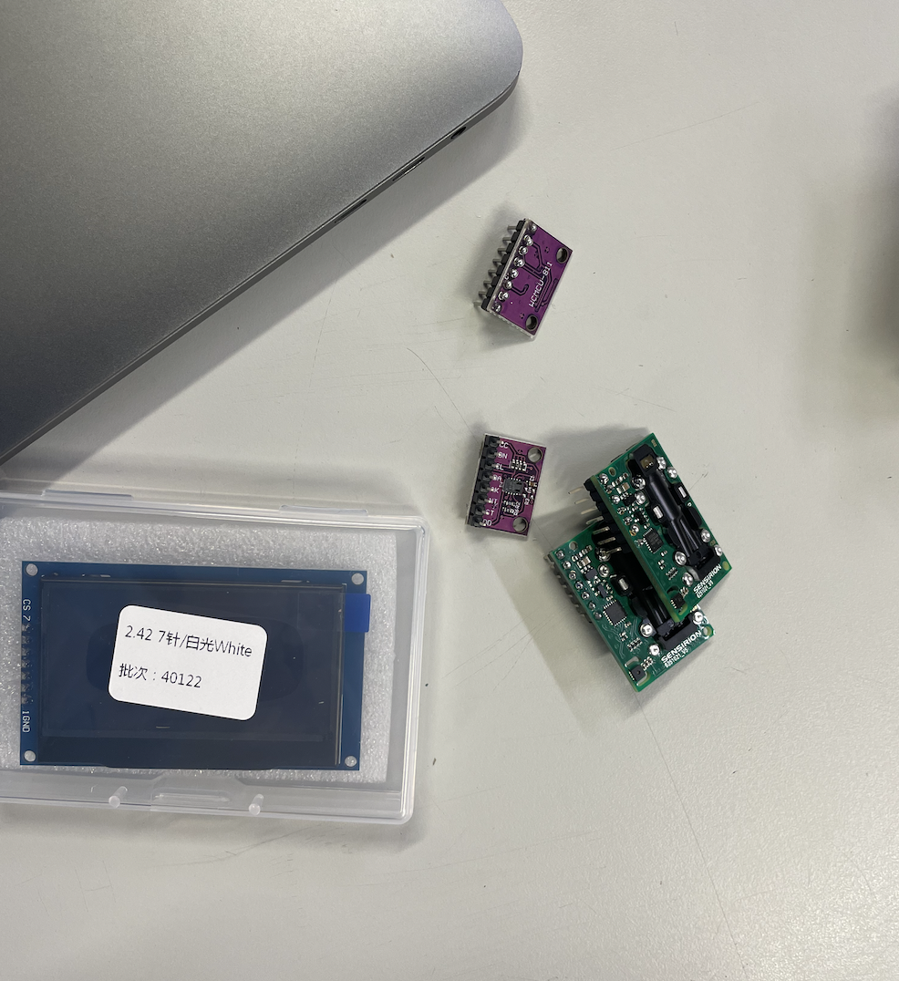

Bill of Materials:
  1. ESP32 Amazon
  2. Temperature and Humidity Sensor (DHT22) Amazon
  3. CO2 Sensor (SCD30) Amazon
  4. Air Quality Sensor (CCS811) Amazon
  5. OLED Display SPI (SSD1309) Amazon
  6. Bread Board Amazon
  7. Jumper wires (female-female), (male-male), (female-male) Amazon
  8. 3.3v Micro-USB to USB connecter Amazon
  9. 12mm Momentary Buttons for Breadboard Amazon

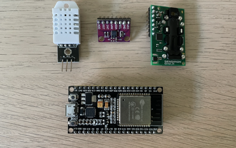

When it comes to electronics its one of the most important parts of the weather station as these sensors must be able to translate accurate data from their readings without many fluctuations. I have researched and chosen specific sensors for each different reading.
Components:
DHT22
A temperature and humidity sensor is a device designed to measure both temperature and relative humidity levels in the surrounding environment.
One popular example of a temperature and humidity sensor is the DHT series, which includes sensors like the DHT11 and DHT22. These sensors provide accurate and reliable measurements of temperature and humidity.
Parts of the temperature sensing component:
Thermistor: This is one of the most common temperature sensing components. It's a type of resistor whose resistance varies with temperature.
Temperature-Dependent Diode: By measuring the voltage across the diode, the temperature can be inferred.
Capacitive Humidity Sensor: These sensors measure relative humidity by tracking variations in the capacitance of a moisture-sensitive dielectric material.
Air quality sensors are devices designed to measure various pollutants and contaminants present in the air.
Gas-Sensing Component:
These sensors are designed to detect specific pollutants commonly found in indoor and outdoor environments.
This component may include algorithms for data filtering, calibration, and conversion of raw sensor readings into meaningful air quality metrics.
Limitation:
Air quality sensors are unable to output specific data such as carbon dioxide levels or carbon monoxide levels.
CO2 Sensor (SCD30)
CO2 (carbon dioxide) sensors are specialised devices designed to measure the concentration of carbon dioxide gas in the air.
"The output voltage of the module falls as the concentration of the CO2 increases. The potentiometer onboard is designed to set the threshold of voltage. As long as the CO2 concentration is high enough (the voltage is lower than the threshold), a digital signal (ON/OFF) will be released." Arduino.com
An OLED (Organic Light-Emitting Diode) display is a type of display technology that uses organic compounds to emit light when an electric current is applied.
OLED displays offer several advantages over traditional LCDs, including higher contrast ratios, faster response times, and wider viewing angles. They are commonly used in electronic devices such as smartphones, smartwatches, and digital cameras.
This display will showcase the translated data from sensors into actual readable data, which we can interpret.
The OLED specific for this project will be using SPI communication, which is known to have higher data rates than I2C.
ESP32
An ESP32 microcontroller, with its integrated WiFi and Bluetooth capabilities, extends the functionalities of the Arduino Uno. It enables the creation of web servers accessible from anywhere, facilitating IoT projects, remote monitoring, and control. Its BLE support allows integration with mobile devices for wireless communication. With enhanced processing power and memory, it's ideal for complex tasks. Using the Arduino IDE to code and upload to the microcontroller.

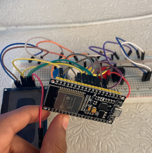

Step 2: Wiring
When first encountering the ESP32 it is important to set up the ESP32 module to the Arduino IDE. If you do not have Arduino IDE please download from the Arduino Website for your specific operating system and follow this detailed guide in how to install the ESP32 Library in the Arduino IDE software Guide.
To set up the ESP32 for sensor integration, I began by connecting the GND and VCC pins from the ESP32 to the power rails of the breadboard. This setup provides the necessary power to all the components. I then proceeded to connect each sensor one by one, carefully linking their respective data pins to the designated GPIO pins on the ESP32, while the VCC and GND pins of each sensor were connected to the corresponding power rails on the breadboard.
Once the sensors were securely connected, I moved on to the OLED display. The display was connected similarly, with its communication pins wired to the appropriate I2C pins on the ESP32, and its power pins linked to the breadboard’s power rails. After setting up the display, I connected five 12mm momentary push buttons to the breadboard. Each button’s connection was established by wiring one side of the button to a GPIO pin on the ESP32 and the other side to the ground, ensuring that pressing the button would register as a signal on the microcontroller.
To complete the wiring, I used a combination of jumper wires (female-female, male-male, or female-male) depending on the connection requirements. This ensured that all components were properly powered and correctly interfaced with the ESP32.

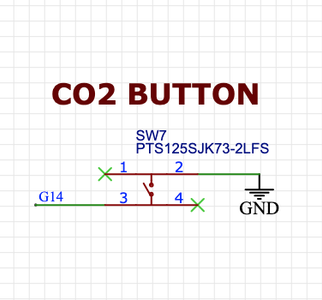

Next Steps: With this, you can create a PCB of the following schematic using the ESP32 as a base, attaching all the various sensors to it, reducing wire interference and increasing portability and durability, however this would be a side project and an extension, the pictures above are the PCB I had created for this particular Weather Station.
