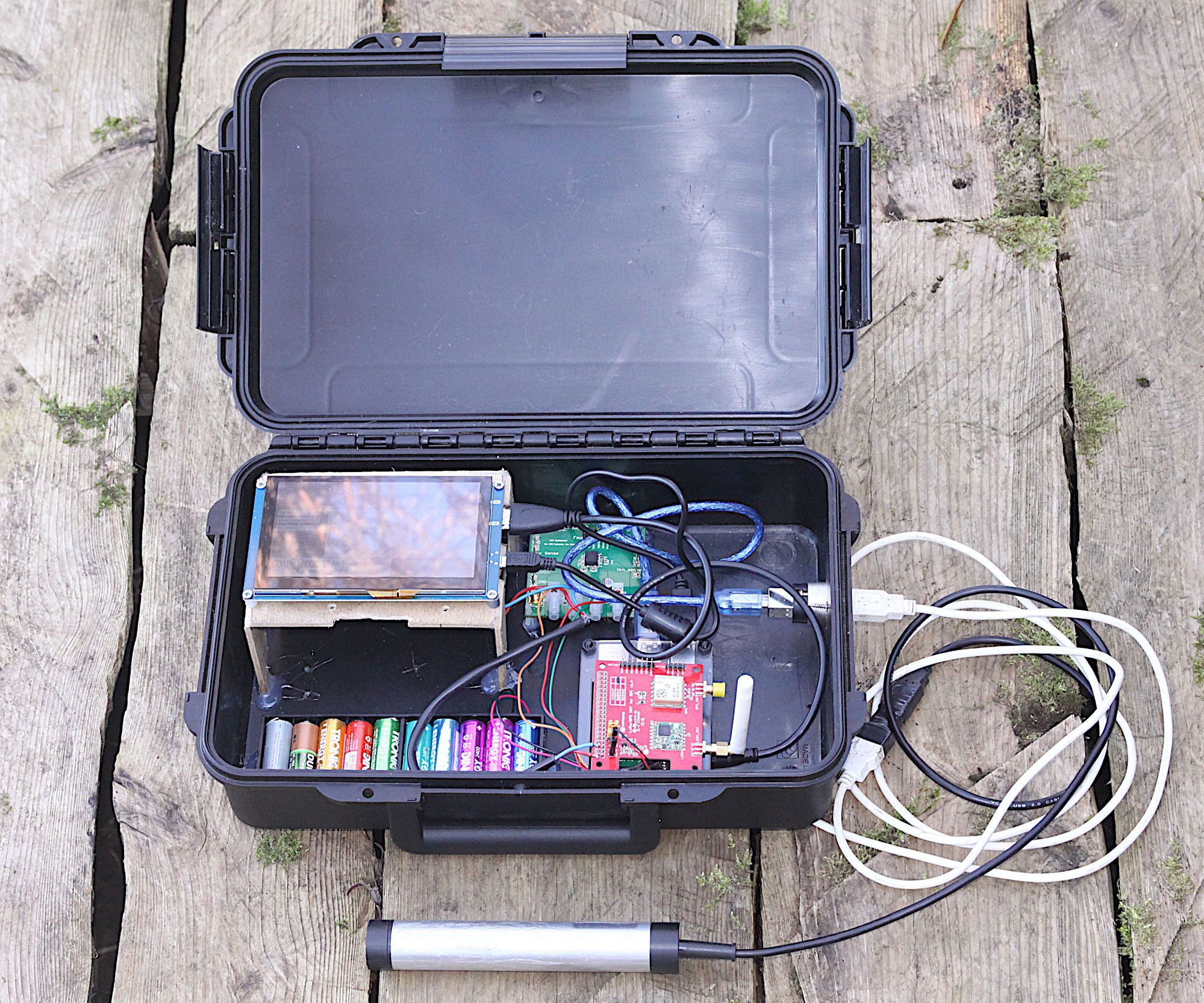

Measuring the temperature and humidity or moisture content of the soil is really useful when deciding whether the ground needs watering or a particular crop can be sown or not. Here, I managed to improve one of the auxiliary sensors from a Sinus TFA weather station to work in the soil.

Having done a fair amount of research, I eventually decided on the Sinus TFA 35.1095 weather stationas it was the only affordable device with 'add on' remote sensors available. I guessed that I would probably be able to modify these external plastic units by adding a stainless steel probe to go into the soil itself. Fingers crossed!

These external units are really well designed and have extra space at the bottom as if they were designed to be improved in the future. The little gadget in the foreground is the temperature and humidity sensor combined on one small circuit board - perfect - it can be disconnected from the main board and reconnected with a much longer cable.
Step 3: Mill a Slot in the Inner Plastic Casing
Use a dremel with a milling attachment to create a slot just bigger than the USB cable to be used. This is for the USB cable routing through the plastic housing of the remote sensor.
Step 4: Solder in the USB Cable
I decided to have a go at soldering the USB cable directly on the main board, but I must say it was slightly tricky and just cutting the wires would have been easier, if not so professional. But I needed to feel like I was doing a professional job even though nobody would ever see my handicraft. The colours on my USB cable matched the colours used in the sensor, which made it all a bit easier.
Now this is the time to test the wiring. Screw everything back together again and replace the batteries - BINGO - it still works!

Step 5: Routing the USB Cable
The first photo shows how the USB cable is routed within the sensor unit. The next one shows the cable, soldered onto the other smaller board, going through a piece of cork stuck in the end of the stainless tube. The next thing to do it turn the tube upright and very carefully pour some resin + hardener solution into the bottom so that it acts as a strain relief device on the cable and seals it from any water. The other end of the tube is plugged with another cork which will allow water vapour to be sensed within the soil but stop liquid water from passing through. Clever eh?
Whilst we've got the resin solution going, we can pour a bit into the bottom of the sensor unit to act as cable strain relief there as well. Just tilt the plastic unit to one side a little and prop it up for 10 minutes or so.
As soon as the resin is hard the plastic unit can be screwed back together again.
Step 6: Siting the Probe
Plant your probe in the shade.
At first I dug a hole out in the field as shown in the photo and mounted the plastic unit on a stick with a rubber band. After a few days, I had a better idea and moved it to a position in full shade as I noticed that the sun had a big impact on the soil temperature, even when the probe was buried 200 mm down. This time I dug down to 200 mm in a full shade location where it never gets direct sunlight and noticed that it was colder and much less variation through day and night.
