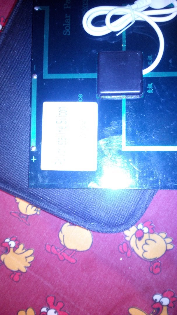

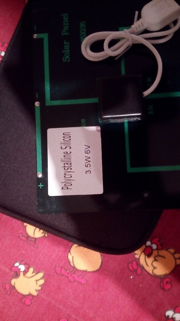

I chose to feed my Rpi using a solar powered system, using 3 3,5W modules bought on Ebay.
The modules output 6V, so 3 modules in series will give us 18V, which is the standard for a 12V solar system.
You can arrange them as i did and you will end up with a pretty nice small panel capable of running the system.

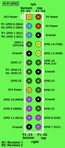

You can connect your 5V to the usual Rpi connector or directly to its header, in this case, pin 2 or 4.
The solar charger has connections for the battery and for the solar panel. Make sure that you connect always the battery in the first place.
It's time to connect the I2C, which are pins 3 and 5 (SDA and SCL) and pins 1 and 9 (+3.3V and GND)

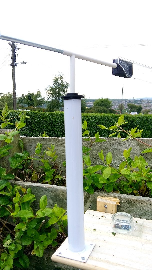

The weather station runs and uploads now both wind speed and direction. I will now show you how the wind direction is working. It is also reading and uploading UV índex.
There are a few projects around that use a setup of reed swicthes to get the wind heading. I always thought that it does a pretty simple solution, but nowadays with digital compasses it seems more appropriate to use one of these small devices. Also, since my objective was to run all sensors on I2C bus, i was sure that i could find one that would fit in this type of bus. So i did.
I am using a HMC5883L, which is a 3 axis digital compass, using I2C bus. You can find ready soldered modules on ebay as cheap as 1 euro. Just search and you'll find them for sure.
One piece of advice with this sensor. I believe that this kind of sensors are quite sensitive, since i managed to kill one. After a few days of getting wrong indications from it, i got a new one and all sorted out. Just be careful , don't drop it too many often.
The other importante part that i used is called a slip ring. What is a slip ring? It's a small device that allows you to have a rotating axis and connections at the same time. There are several parameters that define such device. One is the number of ways(or wires) and other is the rated current accepted through the wires. Since we are only Reading sensor, and in this case I2c, we will need 4 wires and the current is as low as you can get.
I got a 6 wire , low current which happened to have the axis diameter the same as the inner measure of some plastic tubing that i used to build the vane.
The various pictures show how i managed to build the thing. It's not pretty but it dows the job.
