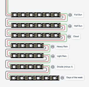

Step 3: The Electronics
I wanted to keep the amount of active LEDs per weather type as low as possible, so I could power them from the microcontroller. That's why I decided to only add 1 LED strip per plate and at the side where the weather element was closest to. So the raindrops and cloud are illuminated from the bottom and the suns from above.
Most strips are 6 LED's but some needed less, like the raindrops.
So eventually this is what I needed:
  • Sun: From top side = 6 LEDs
  • Partial sun: From top side = 6 LEDs
  • Cloud: From bottom: 6 LEDs
  • Heavy rain: From bottom: 4 LEDs
  • Soft rain: From bottom: 4 LEDs
  • Drizzle: From bottom: 3 LEDs
I added 1 extra strip of 6 LEDs in the front to indicate which day of the week we are, so I could have a 6 day forecast. The first LED always shows the next day and every next day in the cycle lights up the next LED. To make it easier I gave weekend days a different colour.
Now I had to solder all the strips into 1 long string and install them into 3D printed parts. I started with the LED strip the closest to the microcontroller and each time I soldered a new one to it I tested if everything was still working. Believe me, those 4mm strips aren't easy to solder :)
When the strips where connected, I installed them and did some last tests and used some tape and hotglue to keep it all together.
